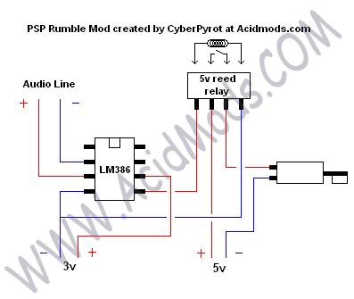

Here is the wiring diagram for you to add rumble to the psp.
Reed Relay specs:
Type: OMR-112H
Application: UL E822922
Rated coil voltage: 5 VDC (at 20XXX°C)
Operating voltage: 3.5 VDC (at 20XXX°C)
Release voltage: 0.5 VDC (at 20XXX°C)
Maximum applicable voltage: 8 VDC (at 20XXX°C)
Maximum switching power of 10 (watt/VA)
Maximum switching voltage of 60 VDC, 120VAC
Maximum switching current of 0.5 A
Maximum initial contact resistance of 150m ohms
