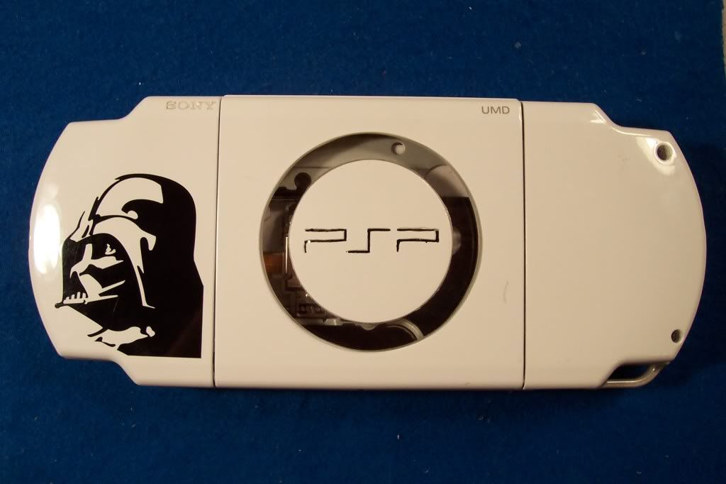

So here I have a blank Jewel in the Slim UMD door now. I Spent about 3.5 hours doing this...No joke lol. All i used is what you see in the third pic which was a box cutter and a fine file that has a curved edge. Using power tools like a dremel to cut and sand are just asking for trouble.
Steps I took-
1. Peel off the ring
2. Cut out the middle circle with the PSP name with the box cutter.
3. Sanded with the fine curved file until PERFECTLY circular...not kidding, this is a perfect circle.
4. When I thought i did enough I tried putting in the jewel.
5. It fit, but was still a little to tight so I sanded some more.
6. When it fit snug I put very little amounts of supper glue spaced evenly apart around the circle
7. Put the jewel back in flush with the door and let dry.
8. When dry, washed with water.
DONE!! This mod takes a lot of patients and time to make perfect so take your time! :tup:

Today I put a blank jewel in the UMD door!! Check it out and tell me what you think!  :w00t:

nice perfect circle

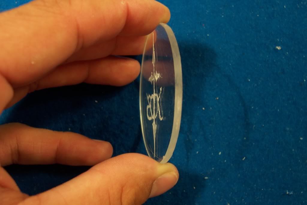

You can make em' out of CD cases if you can cut them out in a circle and you use the thick kind, of course you can't have them engraved but they work for plain jewels :)
I did that before and from what ppl say it is not reliable better of buying a piece of plxiglass and shaving it down.
For example i did ring all hand done with power tools and hand shaving tool take a look.
That is pimpin'

yea i also made a regular clear jewel i have video here.
PSPM3 Modded PSP
