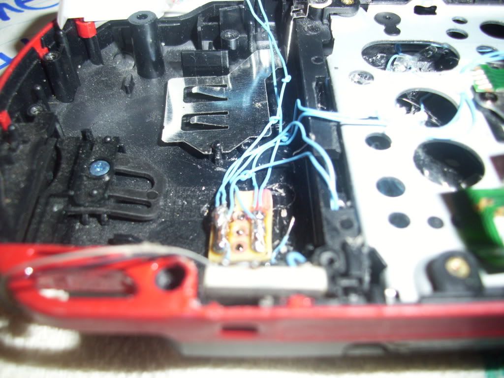

guys can you tell me what this thing called...arioch really is neat when it comes to
his wirings...can you suggest or give me pictures of how you wire yours..
im really having a hard time wiring all together the end of my wires..
thanks guys.. :tup:

it looks like just some custom pcb board, just using it as a terminal strip by just putting solder on the copper traces.

Ive recently started doing that
Just get some stripboard and cover the strips in solder, and then its VERY quick and easy to connect wires together

It is PCB he used those to connect the wires to so it would be cleaner job and less pain.

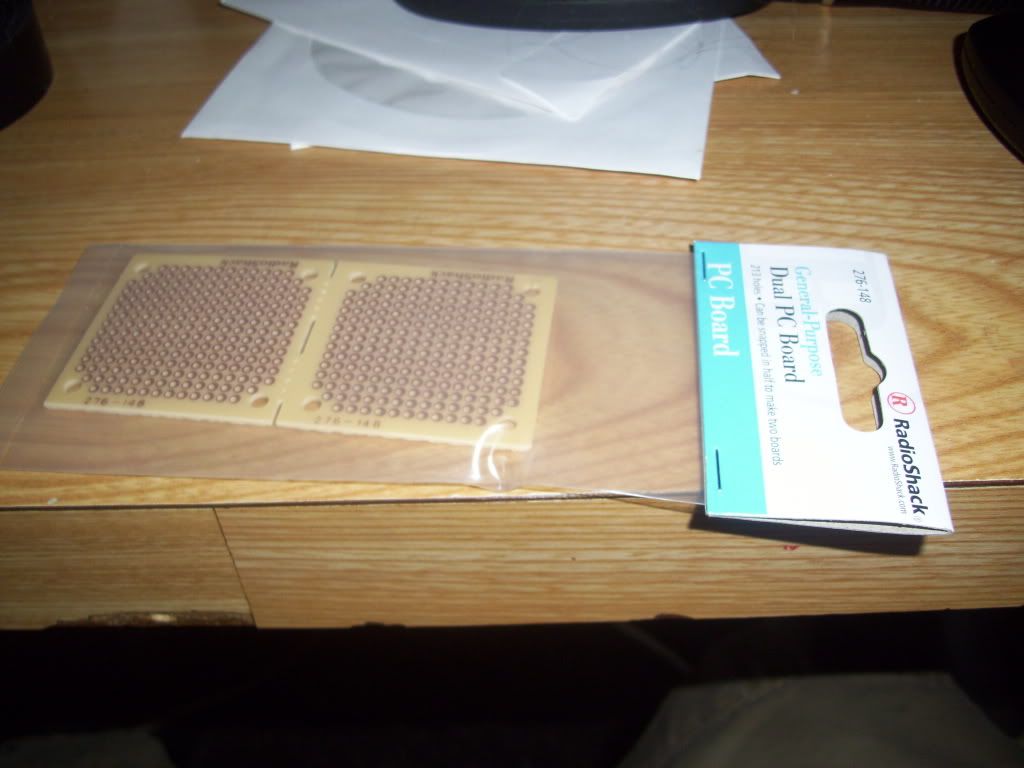

heres what it looks like $1.99 at rat shack LOL you can cut it down to the size you need it comes in handy for alot of stuff and does make it easier to wire stuff up in a psp

Does solder even stick to that? I don't get what you guys mean, so get some of the board stuff and just make lines of solder on it.

yeah i like to use it to connect all my LEDs behind the wifi board makes it alot neater and easier to use. give me a few minutes for my camera to charge and i will take a pic of a customers psp i am working on and post it so you can see how it looks.  solder sticks really nice to it too
i still got 6 more LEDs to add to it lol so the solder is a lil messy but will be cleaned up by the time its done just posting the pics in progress so people can see what it looks like minus the hot glue and that lol :tup:
