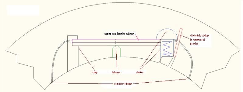

Well I am designing the best option assuming it went into production. (Which it won't) I probably could make a tut on how to make the prototype which will use a pre-made piezoelectric striker most likely if I can find one.. Anywho here's a diagram of a possible design for the piezoelectric striker element. It is inside of a cutout of the ring. (the rest of the ring doesn't really have any electrical components)
The basic idea is, an outside signal will trip the clip which will release the striker to hit the quartz. This will send a charge temporarily through the two leads to the contacts on the finger. Still need to look into it more but this is what I got so far.
I still have no idea how to compute what kind of voltages a set-up like this would produce because the equations have so many variables and deal with matrices which I'm not familiar with beyond the basics.

I'd say use a flash capacitor, although that might be a tad large...

Not to challenge ur whole idea but why not make it a necklace or a watch both would give you more room to work with to fit all of this and a remote trigger mechanism in a ring seems a bit ambitious as you stated you don't really have specialized tools to fab ur own parts and such.

Well, it would be challenging but not impossible. I have access to all the fab tools the school has.
