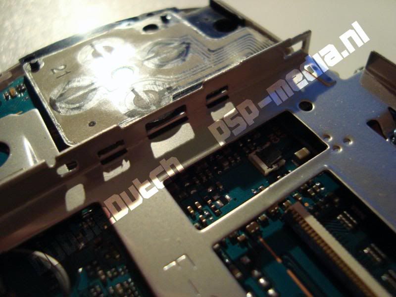

I am gunna swap my memory stick LED and Wi-fi LED so I took off the face plate, but the LCD frame was in the way a bit so I took it off. I cut out the LED and didn't put a new one in because I need some solder paste D: . I put everything back together, so I could play some games, but then I couldn't press right on the D-pad. It is really annoying. I think it is because the end of the button where it kinda cuts in is hitting the edge of the LCD frame so the button can't go far enough down to push the rubber. I know it's not the contact point because I can push the rubber with the faceplate off and it works. Did I do something wrong while putting it back together? Has this happened to anyone else? If anyone needs me to post pictures of my psp I can do that.

i used to get this problem all the time
Did you put all the screws of the cage? do you you have a trigger mod?
Re: [Help] Right arrow on D-pad
« Reply #2 on: April 13, 2009, 10:50:05 PM »
look at the picture below
you see these small black tabs from the d-pad plastic thing ;)
those NEED to be in there! otherwise you will get that problem
and with in there i mean in the LCD cage :P

Thanks DubbleDutch! It worked :D. I havn't checked the analog yet though :S Hope it works. If I knew hope to + rep I would :S
