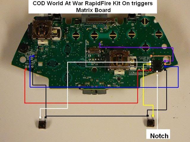

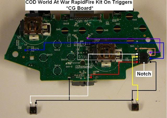

COD World At War RapidFire Kit On triggers CG Install:
Pin out : Please ignore the colors just look at the Picture For Reference as your wire may be Diffrent color

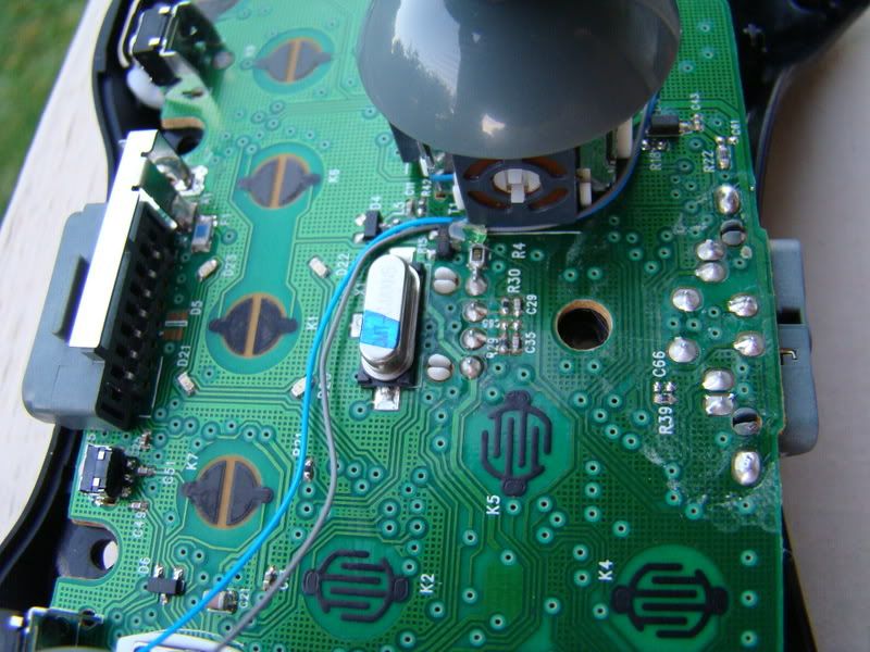

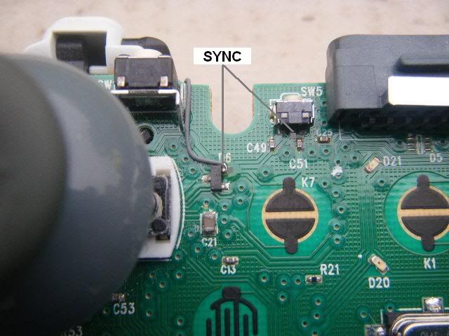

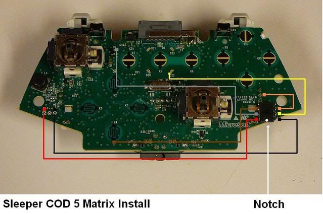

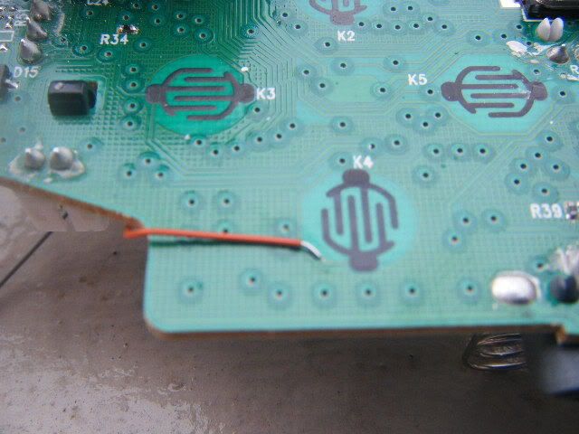

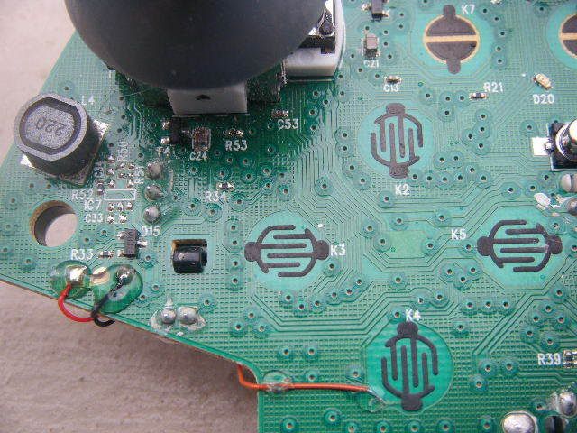

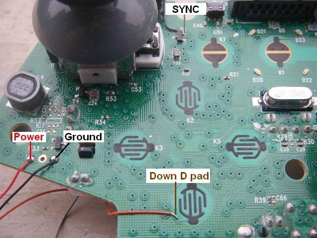

COD 5 Sleeper Matrix Install:
*Warning* This install requires an advanced skill level. This mod involves scraping very delicate wire traces on the circuit board and could result in PERMANENT damage to your controller. Acidmods is not responsible for any damage that is caused when attempting this install.
here the Pin Out : Sleeper COD 5
Hot Glue Can Help Hold Your Wire In place after You Solder Them.
« Last Edit: January 28, 2010, 12:13:31 PM by 802Chives »

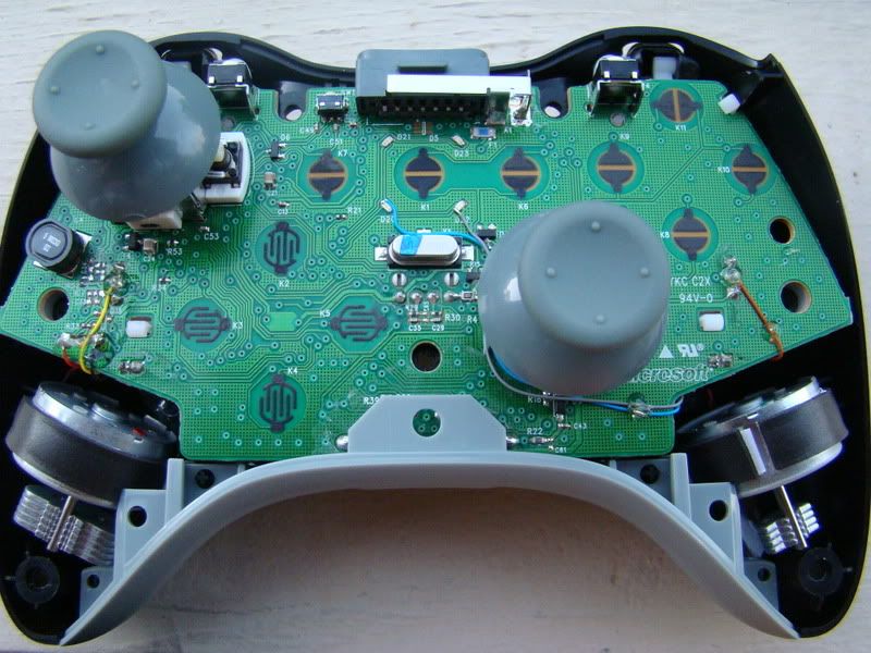

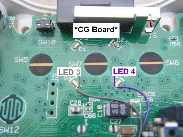

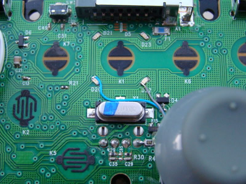

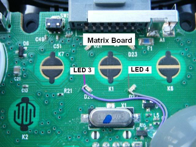

COD World At War RapidFire Kit On triggers  Matrix Install:Pin out : Please ignore the colors just look at the Picture For Reference as your wire may be Diffrent color
This is Example again ignore the Wire Colors Please make sure that the LED4 is bottom and LED 3 is Top
« Last Edit: January 28, 2010, 12:14:02 PM by 802Chives »

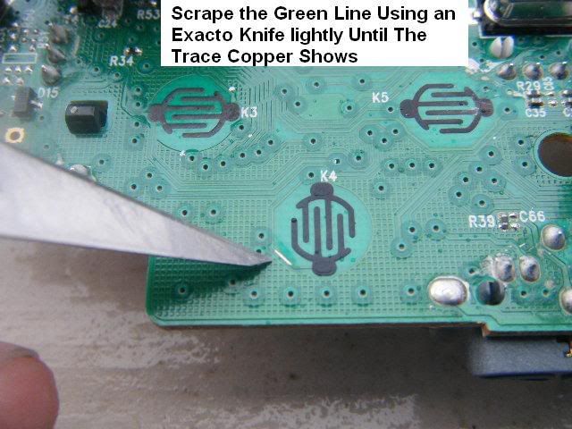

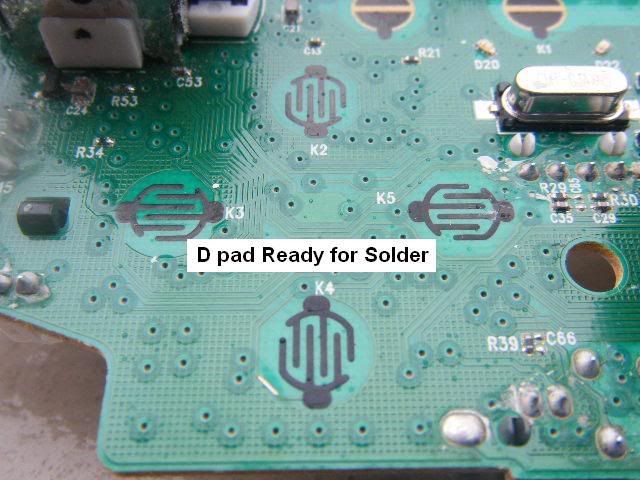

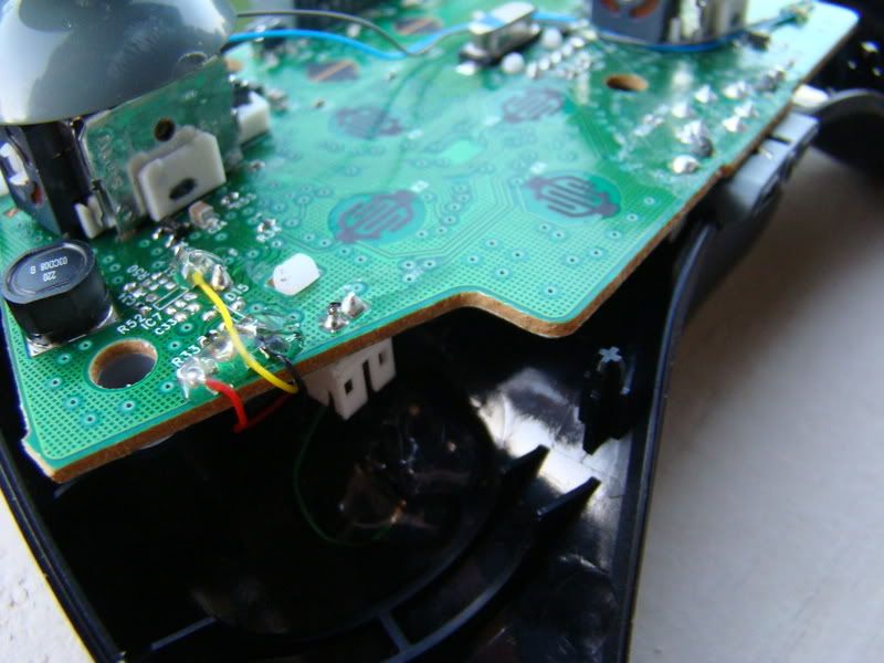

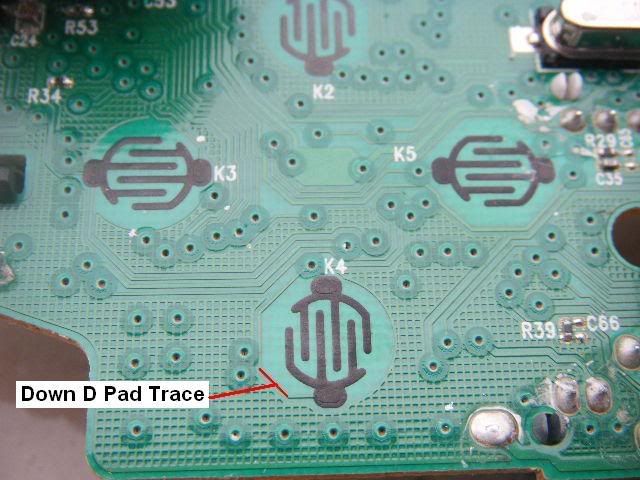

COD 5 Sleeper CG Install:
Led Pin 7
D pad Point for On/Off Rapid Fire Pin 3
« Last Edit: January 28, 2010, 12:14:39 PM by 802Chives »

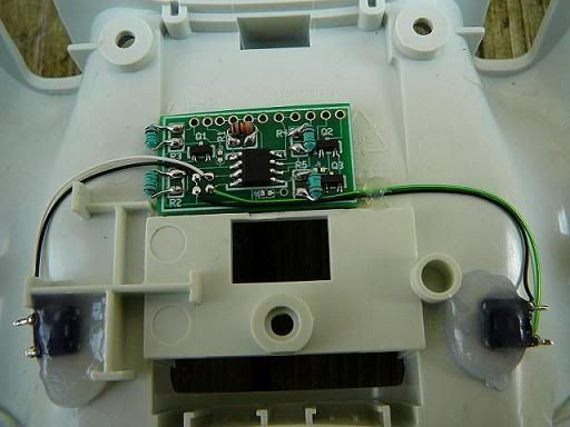

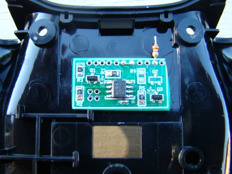

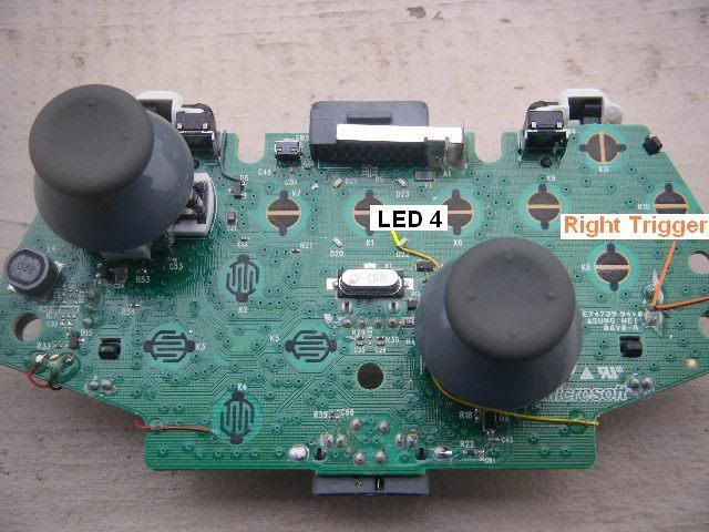

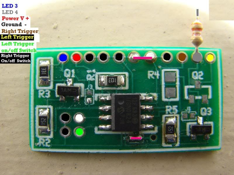

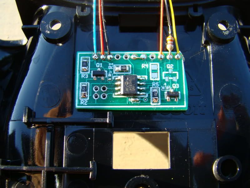

COD4 3-MODE INSTALL(Rapid Reload) -Matrix
Made by Gameroms
i decided to do a install with the new COD4 3-MODE kit, heres a link to the new kit
https://acidmods.com/ShopUSA/product_info.php?products_id=88
******NOTE*******
I'M DOING INSTALL BEFORE ALL MY SURFACE MOUNT PARTS GET HERE, SO I WILL BE USING 1/8 RESISTORS.  ALL KITS WILL COME PRE-ASSEMBLED WITH ALL SURFACE MOUNT PARTS.
******NOTE******
pay close attention to the guide, i got the orange and brown wires mixed up.  brown is supposed to go to right trigger, and orange goes on back of controller pcb with the blue and yellow.
« Last Edit: January 28, 2010, 12:15:47 PM by 802Chives »

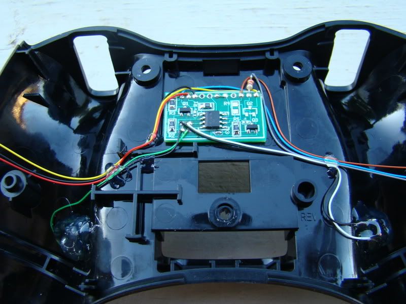

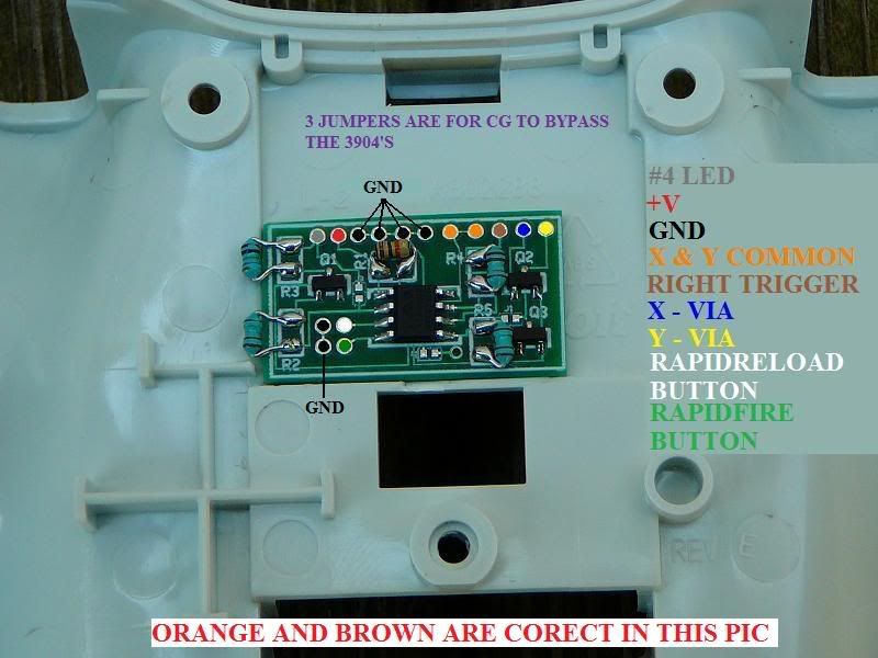

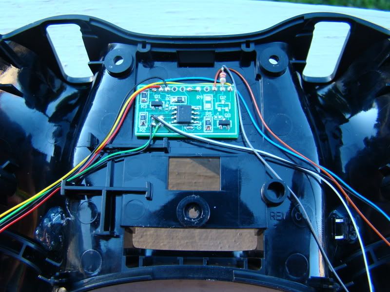

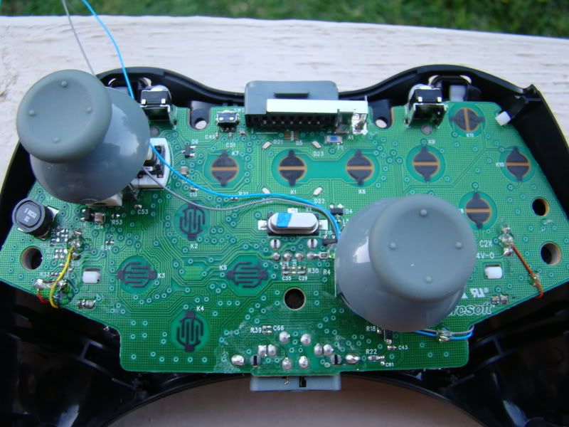

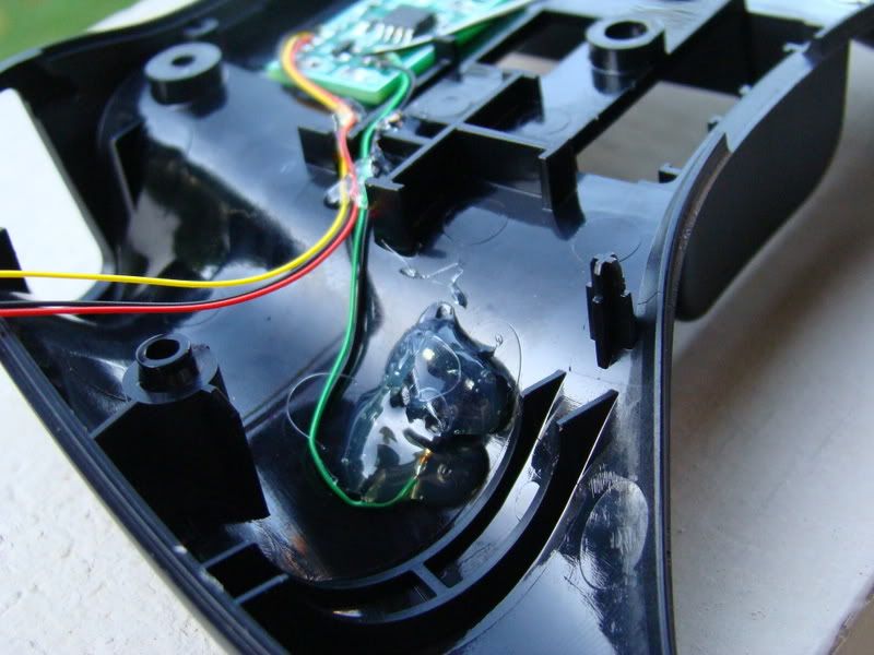

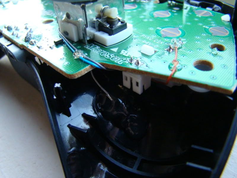

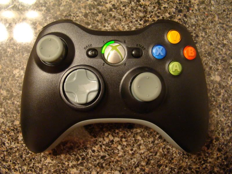

COD4 3-MODE INSTALL(Rapid Reload) -CG
I JUST MADE A SIMPLE GUIDE WITH PICS TO SHOW YOU HOW I WIRE IT, AND TRY NOT TO CONFUSE ANYONE.  IF YOU HAVE ANY QUESTIONS PLEASE POST IN THIS THREAD AND MIKE, CHAD OR MYSELF WILL HELP YOU.

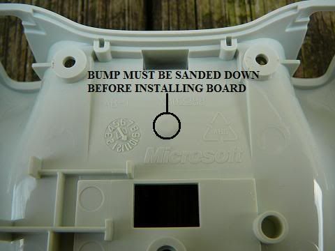

BUMP MUST BE SANDED FOR BOARD TO LAY FLAT ON CONTROLLER.
WIRE COLORS AND JUMPER LOCATIONS FOR CG.
SWITCHES INSTALLED AND WIRES ATTACHED TO BOARD.
THIS IS HOW I RUN MY WIRES.
ALL WIRES ATTACHED TO CORRECT LOCATIONS.
X, Y, LED CONNECTION POINTS.
GND, +V, RIGHT TRIGGER CONNECTIONS.
SWITCH LOCATIONS.
LED WORKING AND COMPLETE.

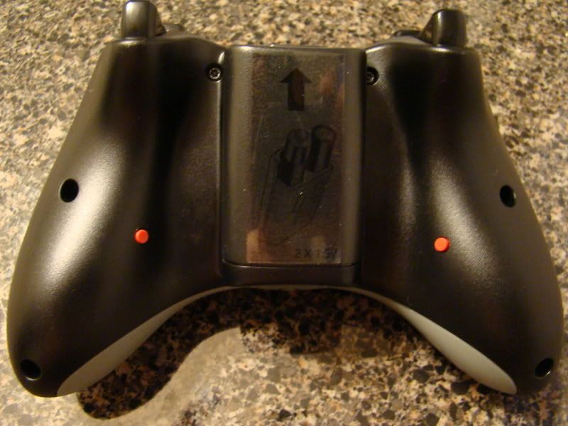

DUAL RAPIDFIRE PCB KIT INSTALL -CG
Must sand bump before board will lay flat.
PCB labeled with colors.
All wires installed.  Left and rRight Trigger wires ran down each side of controller.
Wire cut to length needed.
PCB wired.
Button location.
Complete.
