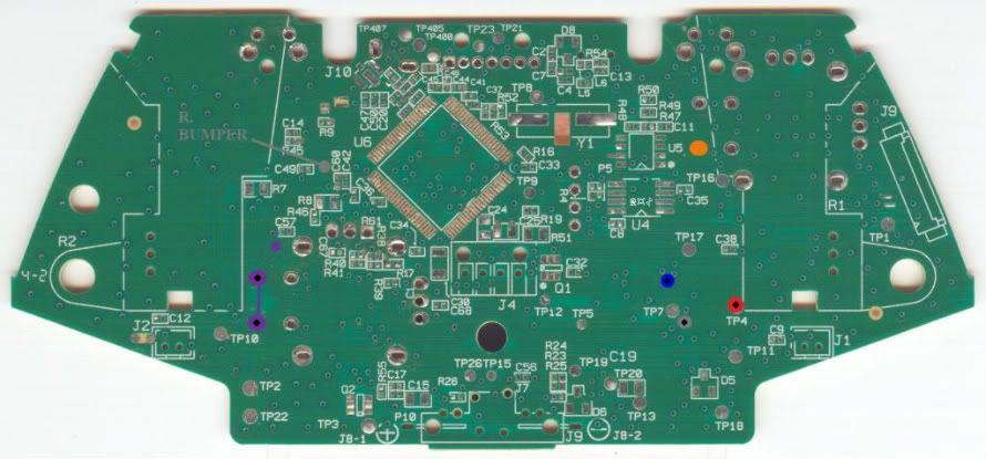

on the back of controller pcb is a test point called TP4, its a +V test point on all controller models.  i use that for everything.

« Reply #2 on: July 18, 2009, 02:56:31 PM »
I dont get what you mean? could you explain please?

alot of the rapidfire chips will turn off when the battery gets so low.  there is one point i use for all versions of controllers
red with black dot.  it switched +V on all versions so it only gets power when the controller is on.  try to stay away fro some of the points that keep +V when controller is off.
