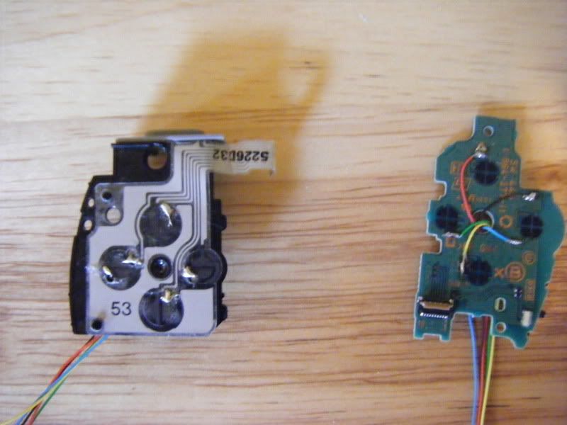

Hey everyone, I am trying a mod that I have seen mentioned a few times https://www.acidmods.com/forum/index.php?topic=25820.30.  I started out wanting a better way to play FPSs by connecting the sq/tri/cir/X buttons to a 2nd nub.  Now after playing Monster Hunter I want to connect the up/dwn/lft/rht D-pad inputs to the 2nd nub.  I do not know if it has a name so I am calling it DBDN for D-pad & Buttons Dual Nub.  Thanks to images and tutorials on this site I was able to splice to the buttons with relative ease.  The D-pad however... was a pain... and a story for another thread, but I will post an image showing what I did.

WOW big monkey wrench! they share a common ground. so the idea of switching between grounds will not work.  So i think i need a switch for the 4 inputs.  I can find some double pole double throw switches. but i dont want to use 2 switches.  is there a 4pole 4throw switch out there?

you could use some sort of relay, this way when u switch it turns the other off, or on, whichever u prefer. i like the idea, but i dont see the point as there is an analog stick.
