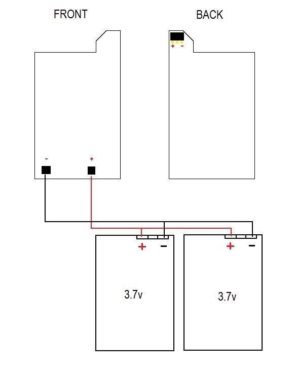

how about this one?
will this work?
i use the circuit board of the phats battery then change the stock cell with 2 3.7v battery..

hey so all you would have to do is connect them to the + & -, Or Would You Have To Connect Them To The Pins?

What I Want To Know How Would This Connect

just connect them to the pins..
the main battery has its own circuit board so it will detect the battery then the
two extra batter just extend ur battery life and as for the circuit board on the
two extra battery they act as regulator so that u won't over charge ur battery
Awilliams357- to be shipped
all you have to do is remove the UMD mod, and stick copper-stripes on the main battery to connect the extra one, i am now uploading the vedio on youtube(not easy in china.)

Hey So 1 Of The Battery Wires Would Connect To 1 of the copper wire on the battery, and the other one to the other one, and i dont need any thing else, i would just connect them both of them and thats it,
and would they both charge if you connected it to charge or would you have to take it out and charge it,
and would it take longer to charge?
ya..just wires the copper corectly (- +), no anything else. the SE battery with circuit protection board(prevent overcharge and over-discharge, just charge them together as normal.no need to take it out.full charge takes 5 hours more or less. then your PSP will last 12 hours at least.
