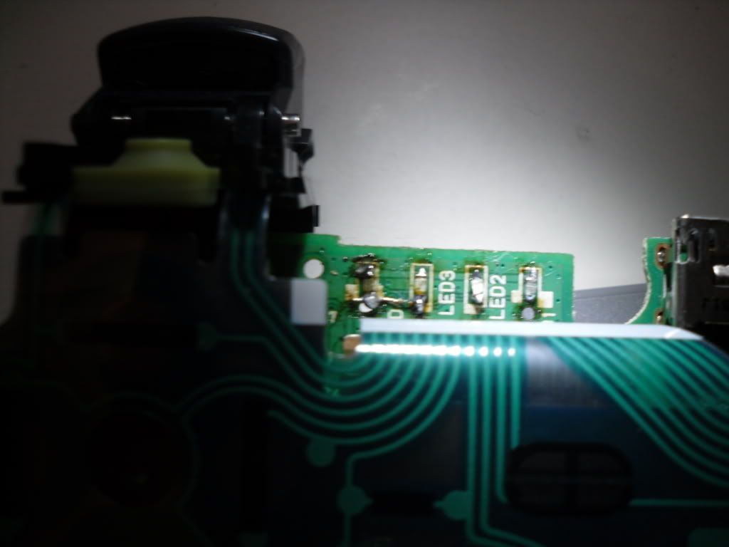

hi ive managed to swap 1,2,3 but 4 i tore the bottom bad off (positive connection) any one know of a alternative soldering point, ive bridged the 3 pos to 4 pos, but that just makes the 4 led another 3 led. (reason i bridge was just to keep all 4 lights working until i can fix 4)

yer its messy lol my first go with any thing smaller than 6mm

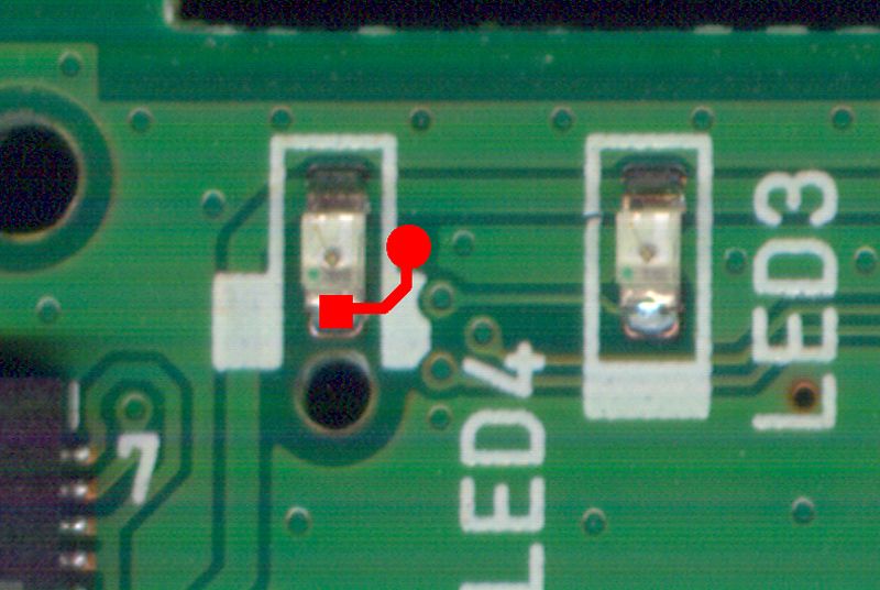

The LEDs in the PS3 controllers are in a Common Anode setup, which means all of the + sides are tied together. It's the Cathode (- side) that gets turned on/off and what is damaged on your controller. The only other place to solder to is on the Via of that LEDs - trace or the back side of the board on a SMT Resistor bank. If you let me know exactly which version it is I can show you exactly where to solder to, but, and no offense intended, from the looks of the soldering on the LED install you should probably cut your losses for now because the repair job will be a bit more difficult.
Offline tomqman
  • Posts: 44
Re: ps3 duelshock 3 led swap help
« Reply #9 on: January 12, 2010, 12:07:49 PM »
got a new iron and had lots more practice since then. and my ds3 is version 0 in this guide http://www.maddogcontrollers.com/PS3_RF_INST.pdf
  • Posts: 2671
« Reply #10 on: January 12, 2010, 01:30:34 PM »
Great, another R/F tutorial where a pic of mine was used without permission. I wouldn't mind it so much if those tools sent me $5 for every kit or controller they sold, or at the very least asked for permission to use it, but I digress..
By version I meant the MSU number on the board, but going from that and the pic you've posted it looks like the MSU_VX 1.03 - Most versions are shown here, including the original pic they bit > http://forums.xbox-scene.com/index.php?showtopic=648322
TOP SIDE for LED 4
BOTTOM SIDE for LED 4
You can try and solder to either Via, or go right to the Resistor Network, just be sure too not don't run the wire where it will get pinched when putting the controller back together.
