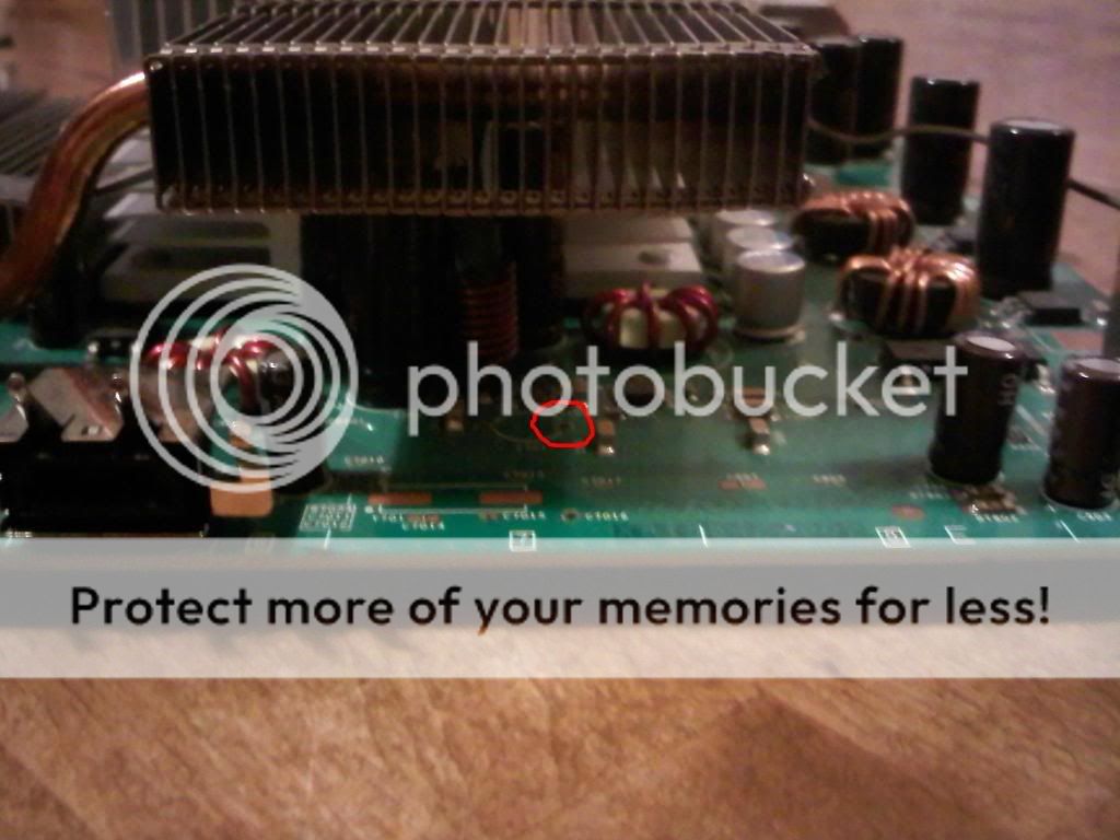

I was testing a mod (LED Scan board... like KITT) on my xbox and didnt see a small bit of solder that jumped my 5v and ground on my PCB board (scan board NOT Xbox).
Well basically when I powered on the Xbox it now gives the 3 red lights.
I know this is because of my dumb*** and nothing to do with the GPU.
My question is.. am I lucky enough that there is a fuse of some kind that would have fried. If there is no fuse does anyone know what I might have fried so I can replace it?
If it helps below is a pic of my solder point where I am getting my 5v power. It is on the under side of the motherboard and on the front of the board. It was the only place I could find on the Jasper where the 5v turned off with with box.

where exactly in this image did the solder fall onto and bridge the 5v and GND?

the short was on the PCB board I made not the xbox.
I pull the 5v power from the point shown and the ground from the #9 point under the power plug.
the solder points on the xbox are clean and the xbox has been working with the wires connected for the last week.
also here is a pic of the solder point from the top of the motherboard. there is no component at its location
