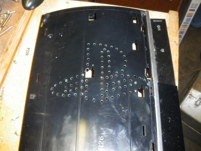

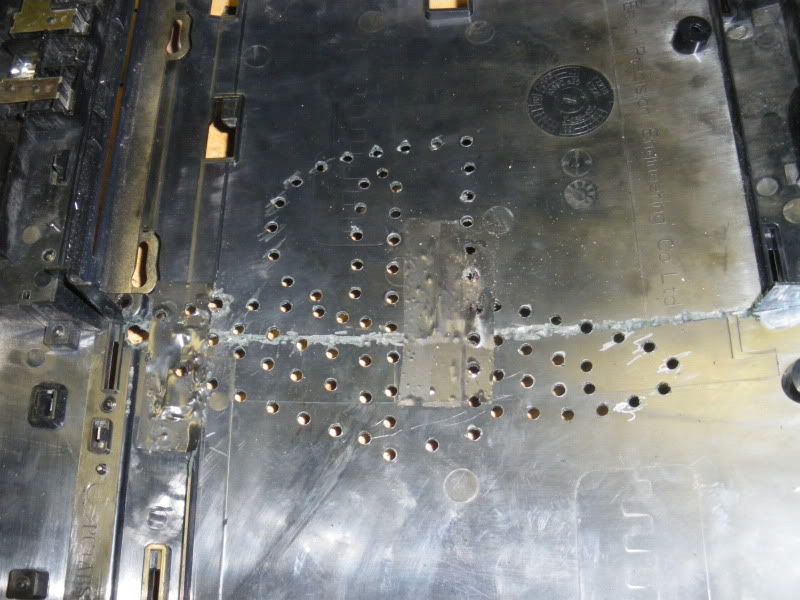

I'm a new member of the ACIDMODS community and as a initiation, I thought I would put the Playstation logo in LED's on the front of my PS3. This mod is very similar to alman101's mod, but I'm going to have different color LED's. Here's a Photoshop preview:
I just recently started this project and I will be posting pictures as I go along. I do have some photos as of right now. I already drilled the holes and now I'm waiting for the LED's, here are the photos I have so far:

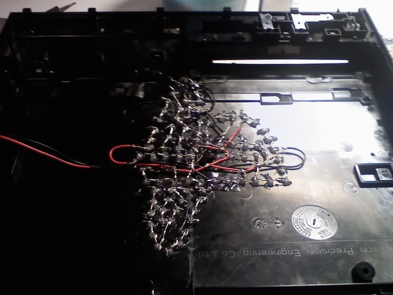

Day 1 of installing LED's
« Reply #3 on: December 05, 2009, 12:18:39 AM »
I got the LED's today and got done after 3 hours of gluing and soldering the red ones (the "P"). I decided to just tap into a 12V source and wire 5,4, or 3 LED series, depending on the voltage of the LED's, and adding the correct resistor in front of the series. Then take all of those series and wire them parallel. It may seem complicated but when it's drawn out, it makes more sense. Here are some pictures (cell phone quality):

I couldn't sleep last night so I spent another 4 hours and finished gluing and soldering the rest of the LED's. I uploaded photos and I'll embed them later tonight. I just got my resistors, so I'm just about to start. I can't start looking for a power source until I get my multimeter in the mail next Monday or Tuesday. I think I'll just go the easy way out and tap into the Blu-Ray. I hope I can finish this today so all there is to do is wire in the inline plug (for easy removal of the top for when I work on it) and the switch (so I can have the LED's on or off while the PS3 is on.
I'm taking a break from soldering, my back and my neck was getting stiff. So, I thought I would post those pictures that I promised.
Will have more tomorrow!
