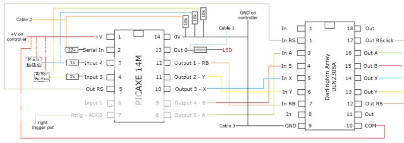

here is a bit of something I came accross a year or so ago just been procrastinating with.

Good ol ULN.
Thats gona be kinda a bigcircuit to install into or around the controller..
Thats another debate im havin with myself.. Should i use the PIC16 that spitfire uses.. or go for something bigger so that ALL buttons are supported.. Something with around 20 pins should surfice! Whats your views?
Peace

Well id probarly want something like a bootloader.. I could write x amount of bytes to change the macros etc.. but thats gona get messy for larger macros..
The chips i ordered support all of that.. There just alot pricier! Im gona play with a few things when they arrive. They do have a wide voltage operating range.. 3-5v.
viking360 uses "Microchip USB HID Bootloader" this isnt there program is it? Its obviously a free-ware program on the net somewhere.. I downloaded it from viking360 but theres no 'about' page or any info on the GUI of the program.. So where could i find its bootloader code for the pic? any ideas?
Yeah a bootloader doesnt even sound that complex to write one from scratch.. basically listen for incoming bytes on a certain protocol. But i dont really fancy writing one.

A USB bootloader IS complex. The one Viking uses is the vanilla USB bootloader that Microchip provides. There isn't any need to write your own, since the manufacturer has one, along with a million 3rd party ones (though most aren't USB). Here are a bunch of PIC bootloaders:
http://www.microchip.com/forums/printable.aspx?m=424874

Check out the CGnome project.   http://www.cgnome.com/  There's also a few pics over at xbox-scene of a working prototype, I don't have the link handy (and I'm not sure if links are censored here or not so I won't bother posting that one too)
Post Merge: November 29, 2009, 02:33:33 PM
Oh!  I found it.  Also links are not censored hurray!  http://forums.xbox-scene.com/index.php?showtopic=691809&st=0

The last they reported, they had full remapping of the analog sticks and some single-button macros fully working with thier PC utility. It was all shown in a video. The only two bad things were they were programming the chip ICSP and the macros were only good at simulating the press of a single button at a time (never macro two buttons at once). I consider these two points as major flaws that need to be fixed. Considering they are the only project to have come this far with working proto-types and full featured PC utilities, those flaws are insignificant. The amount of work already done is beyond impressive.
But it is also not flawless. There is room for improvement. I would suggest taking a real good look at what they have done so far and use it as a baseline for your project. Some of the features you may consider as completely useless, others as bare-minimum-requirements.

Wow the pics arrived today! There alot smaller then i expected! There tiny! probarly too small!
Re: XMMC - Xbox Macroable Mappable Controller
« Reply #23 on: November 30, 2009, 12:42:11 PM »
as long as the pitch isn't under 1/2mm then they are humanly solderable lol.
« Reply #24 on: November 30, 2009, 12:57:16 PM »
smd lol good luck with that. they are soo close together. need to get them on pcb
Soldering them isnt a problem.. I consider myself a decent solderer.. However as matt mentions above.. you really do need a PCB.. its just sooo hard to program else.. and i dont want wire everywhere.
This project is most defently gona get completed eventually.. And yes i will supply a installation tutorial.. but trust me..it wont be for the faint hearted! I need to order a TQFP proto-board.. Then have PCB's made. Im still debating on the PIC to use.

yes this project does sound like it'll be a challenging install (once it's all finished,tested and what not) i cant wait to ava go at doing this

Yea there is no doubt you are going to need a pcb, lucky I got access to a cnc pcb mill :D
Probably going to be a huge amount of wire install, where are you planning on mounting the chip?

Well.. Like i said not sure if im using this chip yet.. But damn its tiny.
Will defently need a pcb for install else your gona get shorts across the pins.
The pic as everything needed and much more.. But its quite pricey.. I ordered 10.. at like 6.50GBP each. Im not bothered but i know others will be cheap scates!
Now ive got the pic's i probarly will use them.. I have to make yet another order on farnell.. I need some solder wick, TQFP protoboard.. some other stuff i need to order too.
Im gona take this project slow.. so dont expect a release soon.. But i can almost guarentee there will a good release in the near future.

The SMD is tiny, but necessary. They dont make anything DIP beyond 40 pins anyway. But the 64 or 80 TQFP is going to be beyond the skill of most people. Hell, I personally wouldnt bother doing it. If I had to work with one of those chips, I would order the dev board that breaks it out. After dev, I would quote it for assembly. Doing 64 or 80 pins by hand is way too time consuming, and most DIY home ovens are not very succesful (not to mention most people dont have them).
I just looked at Sparkfun. They used to carry some pre-soldered SMD pics on breakout boards, but nothing with that many pins.
