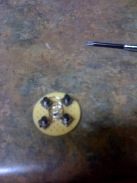

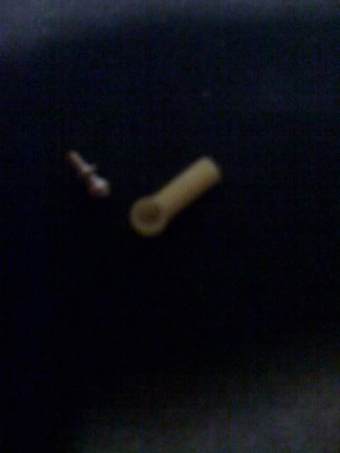

here a diagram of what i plan to do for the d-pad tell me what you think
1. I am going to use the original d-pad guts file it down to the suggest hieght
2.attach it to the breadboard with the tactile switches with one screw dead center
using a spring from a pen in between the original d-pad and and breadboard pushed through the scew used to attach the 2
3. glue the new d-pad to the top of the original d-pad once shaved
4. place either foam or something to give me just enough clearance so when the pad is pushed the screw attaching the d-pad to the breadboard can pivot down and be forced back up by the spring
here is a ball and pivot from a rc control arm I may try to use gluing it flat to the breadboard and screwing the pivot screw in to the base of the d-pad base
« Last Edit: December 01, 2009, 02:13:25 PM by 1god1king »

yeah that looks good and if it works it'll probilly be better then mine.....
i tried to keep mine quite simple..........
but after doing it i have thought of other ways to do it...
so try it out n if it dont work go back to the drawing board ....
good luck with this mod.....
i hope to see more progress on this...
maybe start a new thread in the 360 controller section as som form of worklog....

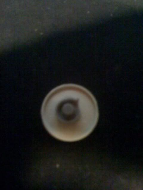

ok heres the d-pad not wired or tested yet just a prototype
I am going to use a flat headscrew for the final d-pad
« Last Edit: December 05, 2009, 03:59:26 PM by 1god1king »

« Reply #13 on: December 05, 2009, 04:45:26 PM »
that looks really good......
infact probilly alot better then the d-pad in my controller....
 :tup:

i was wonder where you got that circular breadboard at 1god 1king.
Offline pigoesfar
  • Posts: 173
Re: looking for someone in USA to do Spurgurgle xbox controller mod
« Reply #27 on: January 01, 2010, 03:47:27 PM »
Not really necessary to bump, you can just pm him.  But, I think I saw that same circular PCB at Radioshack.
Offline Hippijoebob
  • Posts: 32
« Reply #28 on: January 02, 2010, 12:36:18 PM »
srry i didn't mean to bump and thanks for the info on the breadboard.
