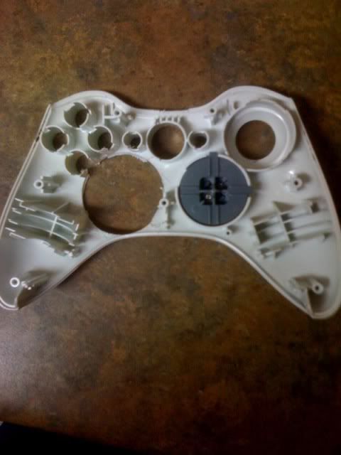

Step 1
Once you have open and remove shell from controller flip over and remove D-pad mechanism there will be 2 screws and 2 clips that you need to push in to remove , see photo #1
once remove set aside as we will be using this shell in the shell mod portion as you can see i have already removed the right trigger portion of the shell which will be done in the shell mod portion
step 2

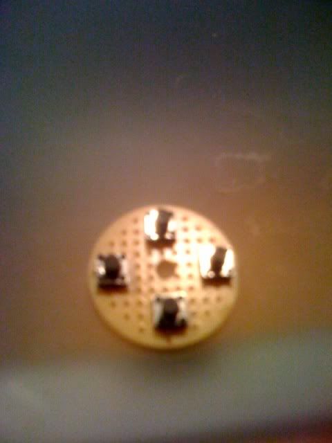

In photo#2 the circular part of the D-pad needs to be shaved as shown in photo just remove the raised portion
so that it will fit in the old joystick sleeve  photo#3 . Keep sleeve to use as stability for the breadboard and D-pad file down any rough edges
step 3 flip D-pad mechanism so that the 2 large holes are down and you are looking at the bottom. Now remove the tip so that it is flat so you can drill .  see photo#4now you will need to drill a hole in the bottom of the D-pad  this can be difficult but possible as there is not a lot of material use a bit smaller than the  flat head screw you plan to use
photo #1
photo #2
photo #3
photo #4

align switches so that they are evenly apart you may need to adjust the legs so that they line up with holes bend legs back to secure for later when we soldier wires
step2
Once tac's switches are in drill a hole in the center of the breadboard  will be using a washer to protect the breadboard  once done processed to assembly
D-pad assembly note once you have assembled set aside as we will come back to this to cut the hieght and add power button D-pad top

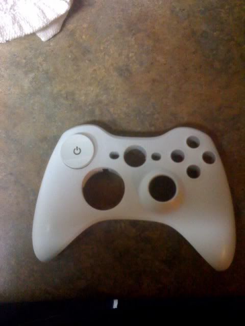

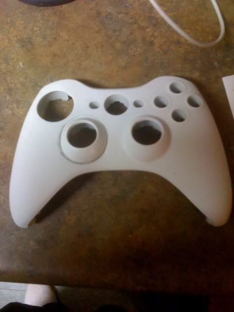

Modding the controller shell

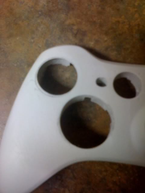

1. 5/8 hole saw used to cut out right controller socket see photo#1A
once removed sand excess until it looks like photo # 1.
2. file to file down d-pad section and removed left controller section
file smooth once you reach this poin the inner excess plastic come right out. as shown in photo #2 also take you time testing to see if pieces fit . remember
easier to remove more than to add more .

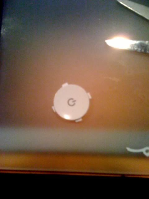

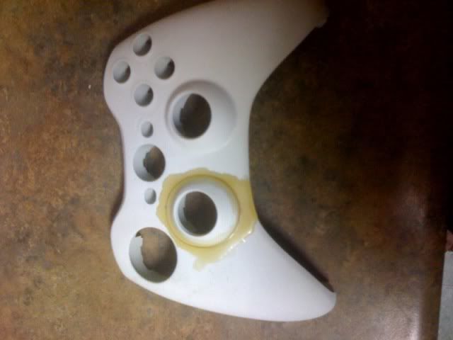

3.photo #3 set power button that we are using for the new d-pad as shown in photo with a pencil out line how much more needs to be removed it is not much so take your time trying so often to see you that you have removed the required amount
4. resin and hardener

photo#1A
photo #1
photo #2
photo #3

update
Ok I was trying to come up with a different solution for the fiberglasss and resin mix
1. guerrilla glue
2. liquid nails
3. crazy glue
I was unsure of how this would sand so I realized that SYSTEM way was the best
so I went out and got a fiber glass kit
man that fiber cloth is a :censored: to work with so I just use the resin and hardener
so if your like me and dont want to bother with the fiber cloth just get a tube of resin and hardener and save a little money . here photo
Installed ready for more sanding and paint

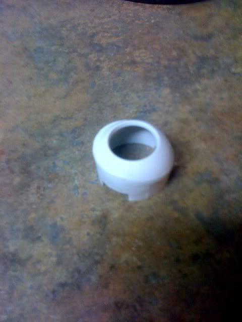

D-pad power cap prep
step 1 cut tentacles as shown in photo #1 & #2 make sure to leave a little as this is what will keep the pad from coming out of the controller
photo #1
photo #2
step 2
Now flip over we will need to smooth down the center for installation to to the D-pad unit
see photo#3 use finger nail clippers to get in to center the smooth with sand paper and set cap aside for later
photo #3
will update complete installation  once i get there :)

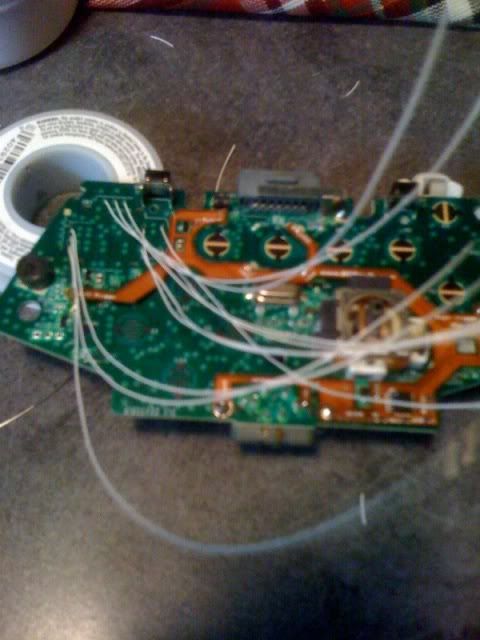

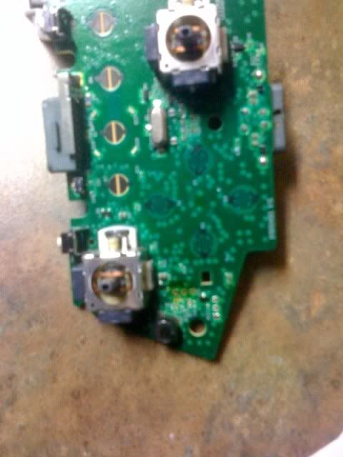

electronics and wiring
controller board prep
First if you are not familiar with soldiering and desoldering or even if you are refresh by reading this tutorials
desolder http://tangentsoft.net/elec/movies/tt04.html
soldering http://tangentsoft.net/elec/movies/tt02.html
tools needed
1. solder iron
2. desolder bread
3. rosin solder flux
4 patience
Now lets continue
step 1
in order to remover the left controller we will need to remove the complete trigger assembly
which means we will have to desolder the trigger switch see photo #1a AND PHOTO 1b the 3 points highlighted in red need to be desoldered
Step 2
with all three solder points desolder and free flip controller over top to bottom
now view photo #2 there are to clips we need to use to remover trigger mechanism top clip push out
bottom push in the whole unit should come free if not make sure you have removed all solder
once done set aside for later
should look like photo #3 &#4 when done
photo #1a
photo #1b
PHOTO #2
photo #3 &#4

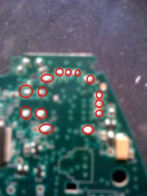

left Joystick removal prep
step 1
View photo  #1 notice the  14 solder points we need to desolder
once done joystick should be easyly removed set aside as will be adding trace wires shortly
photo #1
wire trace update shortly

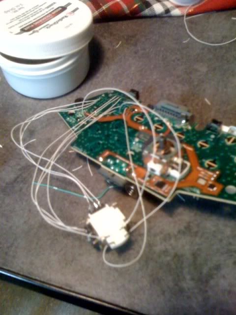

hi 1god1king i've just noticed its a matrix type controller your using for this......
it doesnt really make to much difference but you may find it easier to use a cg type controller as cg is common ground . meaning all the ground can be shared which can minimse wiring a little. such as only 1 ground to all of the dpad buttons where as on a matrix u'll need all 4 ground and all 4 +.
and the same on a cg for the anolog just share 1 ground for x axis y axis and the click down tactile.........
« Last Edit: December 12, 2009, 09:12:35 PM by spurgurgle »

ok been sick man this seems simple but is alot of work
update photo temp wired every thing and tested good just have to do some wire management
and paint shell and put it back together was trying to get this together for my son for a xmas gift but don't know .
this last photo obviously is the trigger soldiered back make sure you fit it correct there is a hole in the trigger and a hole in the controller board make sure it is in will cause you a problem later if not when putting it back together

just got the mask for the case going to get the paint soon . i am going to actually mount the d-pad assembly inside the top of the controller and run the wires out the bottom so it wont be attached to the controller board  will post once i get the shell painted .  just got so much going on psp repairs and soft modding my wii for xmas and the kids :)
once again thanks for your help once finished going to clean it up a bit and make a tutorial out of your great work

okay since i will more than likely never open another xbox360 controller again i have decided to move the plug in power port and add a Tilt Board so the list gets longer lol

Lol why are you never going to do this again.  If this was your first mod then congrats to you for being brave.  You are really good at this if you can pull this off without much xp.  Don't get discouraged.  Thanks for the worklog though.  What did you use to get the dpad at the perfect height?  What kind of spring is that and how did you get the sensitivity right.
Also, are those long tact. switches?  What length?

first this is  spurgurgle mod hence work log for my spurgurgle xbox 360 controller :) just the distance between us doesnt permit him to do it for me and even then i know why you cant put a price tag on it but he is helping along  the wAY
just want to make that clear :)
THE spring is a spring from a losi mini t shock [rc car] cut to height  and basically gives you the spring back
spurgurgle use 7mm .tact. switches so that's what i used
I had plan on cutting the high of the d-pad  on Monday . i am not going to attach it to the controller mobo
but install it in the controller shaft and poxy it at the bottom run the wires out . once i do that will post pictures .
need to paint the controller first which is kind of holding me up .

well what i did was wire the extra wires to the d-pad contacts had them coming out (longer then needed) then wired up the new anolog and stuck it in place hopeing none of the dpad wire's had com lose..... then when i open or close this controller up its just a case of soldering or de-soldering the 5 wires for my d-pad and the 5 wires for the d-pad lights...........all to contacts on the bottom of the breadboard dpad.......
which im quite glad i did cos it means a can take the contoller apart...... which i probilly will be doing soon as im not so happy with the paint job now..... there is a chip on it...... i dropped it onto a nice hard tile floor..... but  it all held up apart from the paint....... dam paint....

ya thats kind of my problem not to good at paint jobs want to do a camouflage have a guy who will do it for me but first i need to assembly and then d-assembly it for all the holes etc i am gonna need he does good work wants to charge me 60.00 for the work but believe me i have a rc body he did for me with perl flakes in it and it is awesome

gotta take the trigger back off for the tilt board instalation. the tilt goes on the bottom of the mobo, let me know if you have any questions
normally you would but i don't as i have the piece out wires to run to the joystick which i moved :)
