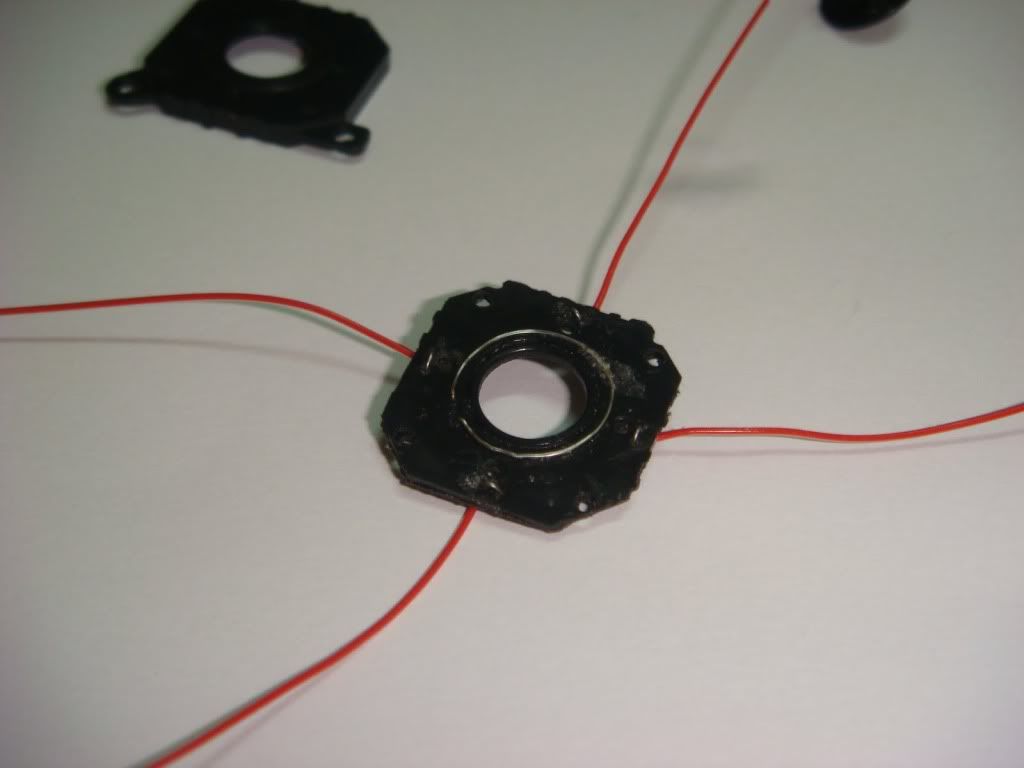

i think this should be on tutorial section.
1st. take apart the nub.
we only need the upper and lower part of the nub.

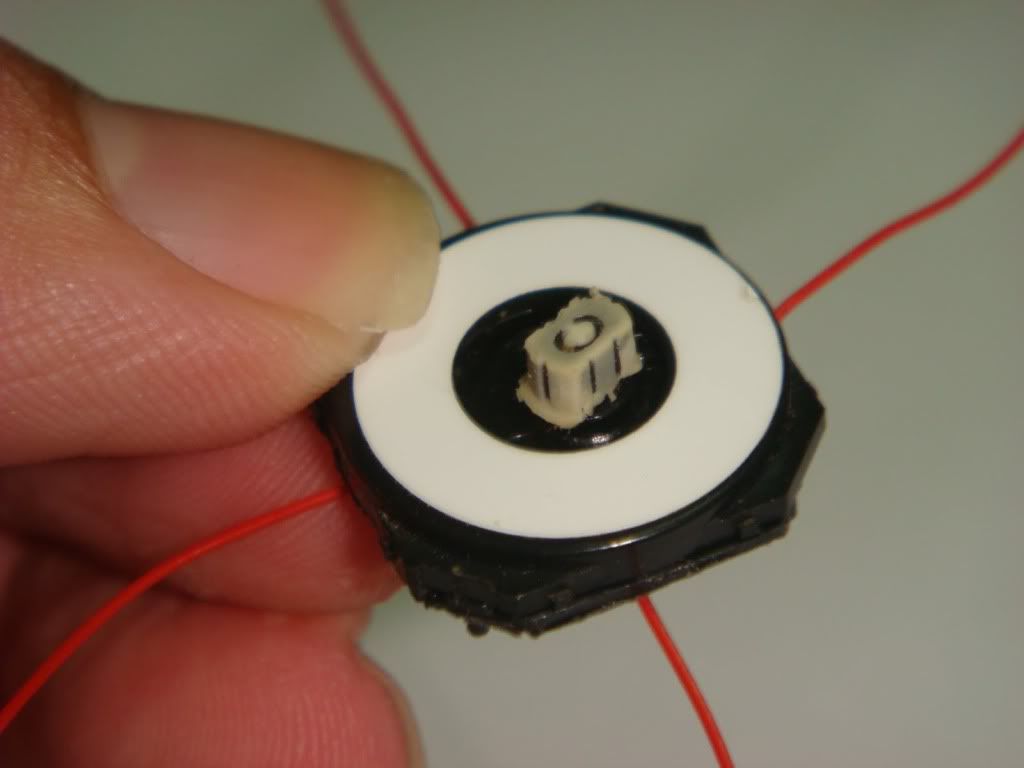

2nd, dremel down the lower part of the nub so it became thin and smaller, the left shows the lower part of the nub before dremel. and on the right shows after.
3rd, by using a small needle, poke 4 holes through the lower part of the nub so you can 'sew' in the kynar wires. the kybar wire on the side ore for /\,[],O,X. and the middle are for grounds.
as you can see the wire doesn't get in the way for the nub to move.
final, put in the spring and glue the stuff together.
it works much better then razor.
sorry for my bad English.

cant see the middle (ground -) wire xD (im a newb) . oh and does this truly work? . and for phat (1000) or slim (2000) or both. o and is this a fat nub or  a slim nub

this method, i have tested. the only flaw the occured. is the spring is a bit noisy because as it move it touches more surface (the kynar wires)
ps: there is ground. its the middle ring of 30awg

but there is only four wires? its supposed to be five? am i right? correct me if im wrong.. XD
Boooh Yah!

« Reply #9 on: January 18, 2010, 03:59:39 AM »
yea. indeed the picture does show 4. its actually 5. 4 for the buttons 1 for ground.
the flaw is that as u move ur spring. it touches the kynar wire (30awg) but then at times if its not flat enuf, etc the spring will get caught some how. but yea once make ur surface as flat enuf. the problem reduces

ah.. i see.. that is the lacking wire on the picture.. but its best there is a vid :)

you wont have any trouble if you place the kynar correctly, try to place the kynar so it will just barely touches the spring when you push the nub.

and 1 more thing, put some grease to make it work much better.
