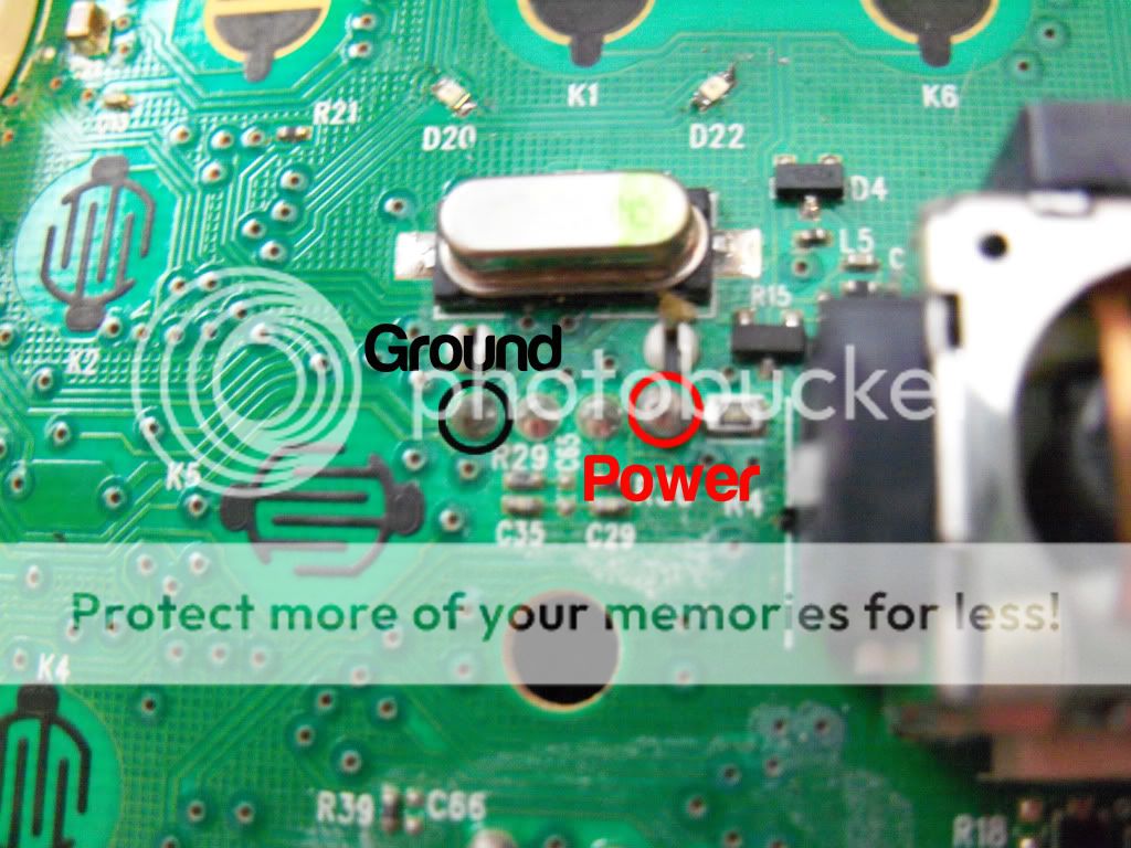

Hey all! I have a quick question... I put 3 Blue 5mm leds into my controllers dome and for some reason they are not working. I have tried countless resistors and just plain wiring it straight to the power and ground. Anyone know what's up with that? Help is appreciated!
Info: THE LEDS
WHERE I WIRED THEM

Ok. you have 2 problems there.
1. You have your ground and + Mixed up on your diagram.
2. The Xbox controller is only giving off 3v and your using 5v leds.
The Xbox controller has 2 AA  1AA = 1.5v,   AA+AA =3v

Hooked up to those points with the controller turned off. With the positive and negative switched from your diagram.
