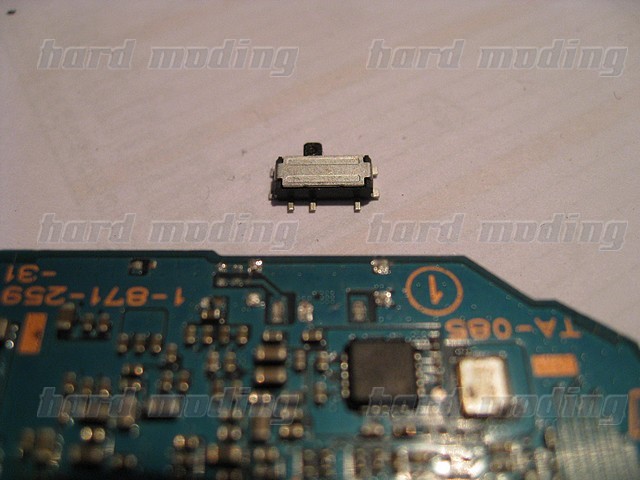

Don't take the Wifi Switch for this, or desoldering all the switch make a bridge on the mobo pin for always ON Wifi, and glu backwards the wifi Switch, after this operation you can use the Wifi Switch for your Diagrams.
If you don't make this the wifi Switch give you a general Ground , and it's not good for that you want to do.
If you don't understand I take Pic after Work.
(Sorry I'm French and I have some difficult to speak a good english)
Post Merge: April 26, 2010, 10:17:11 AM
Here the MOD you must do to use the Wifi Switch for your diagrams:
desoldering the switch
Solder a bridge between the two PIN closest (for Always activate Wifi)
Solder two Wire on the Switch
And glue the Switch like this
Be carefull the switch pin and the bridge should not touch.
« Last Edit: April 26, 2010, 10:18:40 AM by Arioch_76 »
