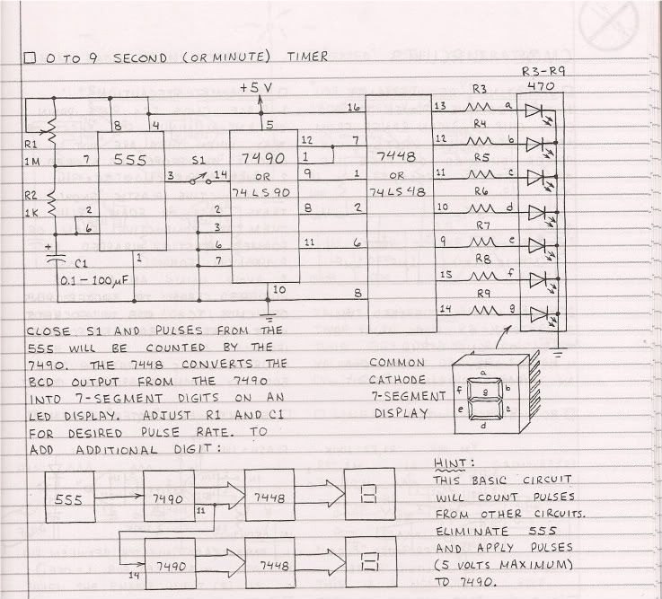

i have a book of circuits that happens to have an 7 segment LED display circuit. i will scan if for you guys tomorrow if i remember but these things are pretty standard and you should be able to find it with google. basically instead of having your indicator wires leading from your 555 to the LED on the ring, you would simply lead it to your timing reading circuits. this will of course take much more space in your controller though.
to do it you will need a 7-segment LED display, 7490 or 74LS90 and 7448 or 74LS48. now i say or because they will perform the same task but you will need to wire it to reset each time you change your mode or it will give a false mode indication.
in all it may be better to drill some holes in the top of your controller for some small LEDs in a row to should which mode in a sort of tally mark because of the space this will take in your controller.

okay so here it is. to make this work correctly you will need your 555 from your rf mod to send a binary code to the counter so that it will display a number. so basically you will need to either reprogram the 555 or have a new one made for you to see the number you are looking for. it will not work by counting flashes that would normally indicate the mode you are in with most programmed rapid fire mods out there.

the 74LS90 is just a Binary ripple counter and you have to serially load clock pulses into the chip.
the 74XX series ICs are TTL which requires 4 Volts to power AND theres no Parallel load in feature.
There is a CMOS Version of the 74LS90 "Ripple Counter" called the 4029B and it has a Binary Up Count and Binary Down Count feature.
There is a 4-bit Parallel load input preset (preset certain Binary values at certain events).
There is also a RESET feature to reset to binary 0.
However if using a PIC you can just tie 7 outputs from a PIC to a 7-segment display to output modes directly BUT you will need a larger chip. Plus if you are going to use the 4029B and the 4511B you will need space for 3 ICs that may not fit inside the controller
So in the long run you should just program a 16-pin PIC to run 7 Outputs designated to drive the 7-segment display to show your mode. Its not that hard IMO, I never really worked with programmable chips but having 3 ICs in a controller without sacrificing rumble motors is just impossible. I'm not saying the mod is hard, its absolutely not, there is just not enough room.
CMOS ICs run on low voltages like the wireless xbox360 controller's battery(2.5 Volts or higher).
TTL runs on higher voltages 4.2 volts or higher.
If you really want to tackle this mod i can draw you up a schematic, but those ICs won't come cheap since they are really well made but be careful that CMOS is static electricity sensitive.
