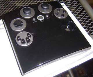

Chuck, the controller you have should be very simple to modify.  A couple of header pin sockets and a ribbon cable and you should be able to stick those babies wherever.  Ben was so kind as to release a modding guide for that controller:
http://benheck.com/10-14-2008/how-to-mod-my-access-controller
I will talk to mike (our shop) and see if he has the parts on hand to get you some cables to work out.  the extra copper in the controller could effect the functions, but there is no harm in trying as long as the connections are all correct

I am ordering the parts this week to make you an actual remappable dualshock controller.
Here is what I plan to do:
Have every button on the controller completely remappable in any way possible with the following buttons: Right and Left shoulder buttons (all 4), Dpad (4), trignalge, square, circle, X, and both stick clicks. I will not change the sticks at all.
I just read about the toggle thing and I can fit that in also. That will be your option to either button press or toggle the action on/off.
This is how I see it: The controller will appear stock with the exception of a 2mm audio jack and a tact button. The tact button is for USB programming only, you hold it for 2 seconds to enter USB mode. The audio jack will be for a special USB plug. You will be able to plug the controller into the USB port and I can make a PC utility to custom remap all the buttons mentioned above.
I can do this with a 28pin PIC. It will involve cutting traces for the 2 commons, and both stick buttons. All the buttons will be individually soldered to the PIC, and the PIC will then controll the commons as it is programmed to be remapped.
I dont know how long this will take. I know exactly HOW to do it, itsw more about the time to get it done. I have work and family so my spare time is limited. Please dont get angry if it takes a few weeks to get this done. I will post progress as I make some progress. More later.

[TECHNICAL] I plan to use the 18F2550. The USB library has the 18F4550 and will be easy to port over in a short time, no re-engineering. I will use the bootloader as the base and then use the HID USB interface for the programming portion.
The only thing that I may need is someone to help with the visual C part of things. I can get the base programming done, and maybe someone else can build the form/GUI to something easier to understand (like a picture of the PS3 controller and drop-downs at each button). [/TECHNICAL]
Just to make my first post clear, I will remap the stick click/buttons. I will not mess with the ANALOG part of the sticks.
Just to make things clear with this design: It will not be a rapidfire controller. It will not be a macro controller. It will be a straight up button remap with the added 'toggle' function. I am assuming Chuck just wants the controller to be ergonomical for him.
Chuck, I will start the base coding this week and order the PIC stuff. As I get to the point of modifying the shell, I will be asking for your opinions on where to place the USB port and the tactile switch. I will show pictures of possible places and you tell me your suggestions.
One thing I wish I knew before yesterday: The 3rd common for the stick buttons and the select/start buttons does not work like the rest. It will require some further testing and alternate way of manipulating, but I have it all in head on how it will work. There should be no real surprises, just have to get down to the grunt work.
In the end, I hope to have the controller that you have been petitioning for in the first place. I would have rather been able to come up with a true ergonomic design for your exact needs, but I can do this rather quickly and your already used to using a stock controller.

To answer your questions: Chuck does not want a Xbox controller. I am well aware of all the different designs for it as well and I have already been working on some dev for the PS3 macros (theoretically). I have already asked Chuck about the possibility of mapping to a seperate tilt control but he has already stated/shown that his arms do not have the mobility to make that work as accurately as he can weild the stock controller now. It is simply a matter of remapping the stock controller that he is already used to.
I do believe there could be a much more involved solution to design something that would really fit Chucks particular needs, but I would say it would involve alot more than can be produced in just a forum thread.
Matt: As i start working with hardware I will provide you with the details. I will say I am going to be using the 18LF2550 with a 48MHz crystal.
Update: November 12: I have the USB chip disabling the R2 button now. It should not be long before I start cutting traces and having the code remap the buttons. Then it will be a matter of making the GUI.

I have cut the traces on the COM2 and R3 lines and I currently have the PIC remapping those buttons depending on a value I have dumped into EEPROM. This means the circuit design portion is done (and it took me a few challanges to figure it out). I will probably write up another 'white paper' on how all of this works AFTER Chuck gets the controller.
What I have left to do: I need to seriously plan out how all of the parts are going to fit in the controller now. I will either have to free-form all of the resistors and the PIC and the jack, or make a prototype PCB and have the whole thing SMD. The PCB will be more robust, but will take a few weeks longer to finish. The problem I have right now is that I have the disassembled controller with a dozen wires hanging out of it connected to a breadboard. Every time I update the program, the wires have to come out and now some of the wires are snapping from the solder joints due to to much movement. I need to internalize the circuit and close up the contrller and start updating through the final USB bootloader cable. The bad thing is, I need the battery recharger and it has not arrived yet.
The next step really is applying the remapping to all of the buttons. This should take less than a week. After that, I really need to work on the USB interface. I have reviewed it and I looks real easy. Both the PIC USB portion and the PC app look very simple to do. What will take me more time is creating the GUI. I am going to practice making a custom Form in VS and making the drop-downs for each button. What I may need help with is making a 'file' and 'savings' part of the project. I want to make the app have the ability to save certain layouts, but I have very little exercise in Visual Studio file manipulating.
If anyone has a good tutorial on how to read and create simple txt files in VS C++, I would be greatful.
Oh, also if anyone has a good picture of the PS3 controller showing all of the buttons as the backgorund for the Form that would help save some time too.

In simpler terms:
The first hard part is that I am placing the PIC chip between the buttons and the controllers main chip. It is not a straight forward wiring job, some other stuff needs to be added to make this work correctly. The buttons are analog (pressure sensitive) and that was the first challenge to overcome.
The reason for the previous update is that I have succesfully completed overcoming that challenge.
The next three things I have left to do are: 1.Figure out how to stuff all these circuits into the controller; 2. Finish the code for the PIC with all the bells and whistles; 3. Make the computer PC GUI to reconfigure/remap the controller for every single game you could possibly play.
This is the first time in over a year I have felt motiviated enough to do a project like this. I wish I had more time to finish this quickly. But I do work on it every single day, little by little. I will keep you updated when I finish each of these challenges.

Hello Chuck,
I know its been awhile, but things have been hectic IRL. I just barely finished the free-form circuit:
I am code debugging when I can get the chance. The software part is about 60% finished also.
I went ahead and got a PS3 to make sure it works OK while using it for real. I hope to be finished in a month. Its hard right now. I get up at 5AM every day, put in 10+ hour days with 2 hours commuting, spend very little time with my boys for fun, and then its about 10PM when the last one is finally asleep. I sometimes put in an hour or two on this project, but sometimes I'm just beat and need to watch some anime to decompress before getting 5 hours of sleep and start all over. Its not much of an excuse, but I will get it done.
