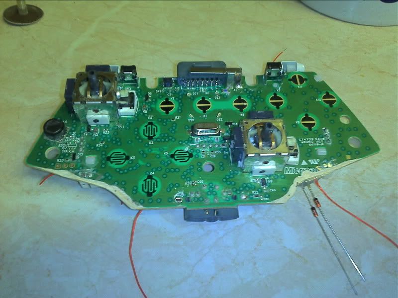

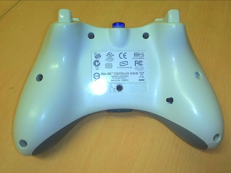

Ok so here's my latest creation.
Internal 800mah AAAs - less capacity but allow the retaining of the rumblepacks. This shows the location of the batteries in the shell.
Trimming of the PCB to ease the fitting.
Location of the PIC socket (however I had to move it slightly on assembly due to it catching on the case)
PCB, batteries in the shell and rumbleshocks
Case closed with multicoloured ROL to match ABXY colours
Front of controller showing tactile X for the FLEX code, usb for charging and charger LED
Showing charging light and FLEX in mode 1
And finally, tactile B button.

Re: My latest creation

Offline radddogg
  • Posts: 53
« Reply #2 on: September 17, 2010, 05:13:28 PM »
I like the X button lol :clap:
Its just a long tactile with the x drilled out and glued on but it does look good and it stays on the board when the shell is opened. One of the things I like about this mod is that its all tidy and doesn't require stuffing together when reassembling.

Offline radddogg
  • Posts: 53
« Reply #11 on: September 18, 2010, 04:42:32 AM »
Lets be honest, its easier and more reliable to use solder tags, however, as they are physically bigger I will swap them for the 3600 mAH batteries when they come.
Also I think the batteries in there at the moment will be fine though. The stock 360 pack lasts for a few days so this pack will last for at least a full day maybe more. If you plug the controller in between uses you'll never go flat and even if play non-stop for 2 days you could plug in while playing.

Offline radddogg
  • Posts: 53
« Reply #19 on: September 20, 2010, 12:36:56 PM »
Right, I've got a problem.
It isn't charging. I've just pulled the 'circuit' out of THIS hong kng charger.
The 'curcuit' is just a resistor then a zener diode then another resistor and i've connected it like below
Only thing I could think was I'd got the polarity wrong. The circuit is putting out 1.6v dc
Any ideas? :beg:
