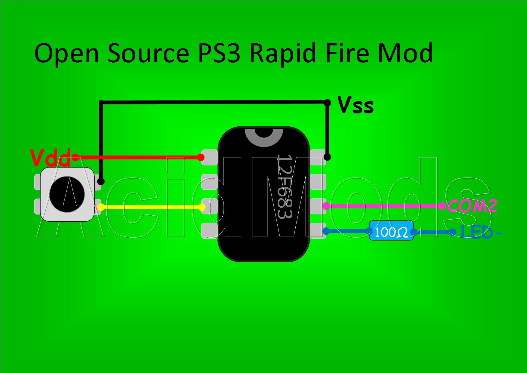

How to use this code
you can edit the speed of each mode in this code just like in bmu by editing the value of FIRERATE1,2,and3 shown here;
Code: [Select]
;***** FIRERATES *****************************************************
FIRERATE1             equ        .167         ;6 sps
FIRERATE2             equ        .250         ;4 sps
FIRERATE3             equ        .125         ;8 sps
;to get desired speed divide 1000 by your desired sps then enter
;it here and recompile and reprogram the code
;Example: 1000/4 = .250
change the values to anything from 1 to 255 to suit your needs by downloading the source text file then open in notepad save as a .ASM file.
next open it in mplab and change the values in the code
then recompile by selecting Project> Quick build
finally program the generated hex file into a pic12f683 and install.
When installed to change mode simply tap the tact switch to toggle modes
mode 0 - OFF
mode 1 - led turns on
mode 2 - led blinks twice
mode 3 - led blinks thrice
Coming soon
Rapid fire on r2 l1 and l2
burst fire
updateable settings via serial comms
then who knows what else
What We Need From You
bug reports
information on what speed suits what game
I am not responsible for any damage caused to yourself or your console or your controller by installing / using this code
for installation simply join up the coloured lines on the diagram to the corresponding dots on the board scans
credit for the pics goes to RDC
https://www.acidmods.com/moddedmatt/PS3V1.HEX
https://www.acidmods.com/moddedmatt/PS3V1.asm

ive tryed to install this in 3 diff ps3 controllers and cannot get it to work ive tryed the precompiled hex supplyed and ive also tryed compiling it my self
ne ideas? ive checked all the wires
Offline rafaliyo86
  • Posts: 569
  • Post quality +12/-1
Re: PS3 BMU V1
« Reply #5 on: November 15, 2010, 12:55:28 AM »
what do you happen exactly?? post pic of your wires if you can

skittles yes thats the VDD. code doesnt work on my VX4 board.i also got problem with this code i know i wired it correctly i tried it 3 diff version of board it seems a bit buggy i mean does work for me sometimes when touch my finger on the pic it changed the mode by itself and you can do rapid fire.
HYPER its not only me have problem with this code  i post it before in other thread but it was ignored because i was new here but i was following HAZERS  code for a long time now.
i hope this will be fixed so i  can edit the speed to play black ops
Skittles i got attached wiring  picture of my VX4 this PIC i bought in EBAY dual mode akimbo (so ignore one extra wire there)

Elimarz
Is there two wires, one going to tpp17
And one to tp18?

ok well the code works
but what i think all the problems above are from a poor, incorrect, or no connection to the r common line this will cause the controller to not rapidfire and not change modes
so may i ask where you have aquired your information about the r common line tp spot on the vx4 board?
Re: PS3 BMU V1
« Reply #13 on: November 16, 2010, 08:36:59 AM »
I have personally tested this code on the V3 and below boards, it works perfectly, the rapid fire is smooth and consistant how it should be, mode change is instant. I unfortunatly dont have a V4 controller to test on. So if you guys have a v4 board you may be SOL
BUT IF YOU HAVE A VERSION 3 OR UNDER AND ARE HAVING PROBLEMS, ITS YOUR OWN DOING.

elimarz i do not have a vx4 controller so cannot personally test it but i have tested other boards so i do not know why it is not working for you and im not saying there is deffinately wrong with your install but the symptoms described would happen if there was an incorrect connection as for it working when you touch the chip that is probably due to your finger shorting the pins or due to esd from your finger
something you guys can test is if you connect the com2 pin(the pin on the chip) to ground, the chip should change modes and the leds should work but rf will not, if this does not work then there is a problem with your setup (most likely with incorrect pins or connection to power or ground

skittles your problem is either one of two things then
1. you have not correctly hooked it up to the r common line
2. the r common line works differently on the vx4 board however this is very unlikely
elimarz if it does not work for you on the vx3 then i have no idea whats wrong but it is not the code

The r common onthe board that I have is The tp 18 or that'd where I soldered it to. Also the point is pretty easy to solder to as the picture I posted earlier shows
Offline hyper999
  • Posts: 1158
  • Post quality +544/-3
  • Research and Development
Re: PS3 BMU V1
« Reply #23 on: November 17, 2010, 11:46:42 AM »
skittles try disconnecting the chip from tp18 completely and then put a jumper from pin6 (pink on diagram) to pin8 (black on the diagram) then press the tact switch it should flash and change modes

just hook it up to the same ground that you hooked pin 8 to

Fundimantaly, all ps3 controllers work the same. I don't see why there would be a problem. Have u tried testing the new code on a v3 board? Do u grt the same results like thr v4 board? Well when i tested the first firmware hyper posted here its working fine. Not quisure about the latest revision. But it seemed like u tested the code on a v3 right? Well there should not be a diference between them. I worked on the ps3 code with everyone from day one and tested multiple times. So i got practice on the controller too. So i still suggest to dubble check connections, solder joints amd other problems you may face.
I thank god for thing to be difficult for the common ppl. Not to be a ass but so people won't sell them. Sorry if that sounded mean but i realy hoped so that nobody would be complaning and selling too. But i digress.
Just do a recheck. :)
