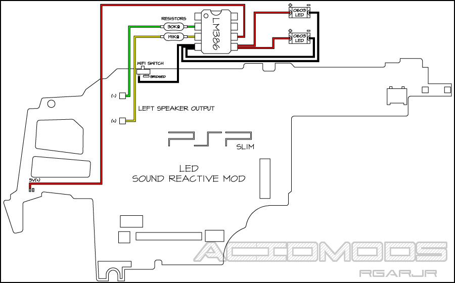

« Reply #20 on: January 19, 2011, 02:34:34 AM »
https://www.acidmods.com/moddedmatt/lm386soundreactiveleds1.png
Is this correct? Resistor to the pin in the bottom on the right side(+ pole to led 0603) ???
Offline nEoVaLoR
  • Posts: 734
  • Post quality +36/-26
  • Young Modder
Re: I'M BACK and I bring you Sound reactive RGB LEDS!!! **UPDATE**
« Reply #21 on: January 19, 2011, 12:42:49 PM »
Yup, that would be correct.
