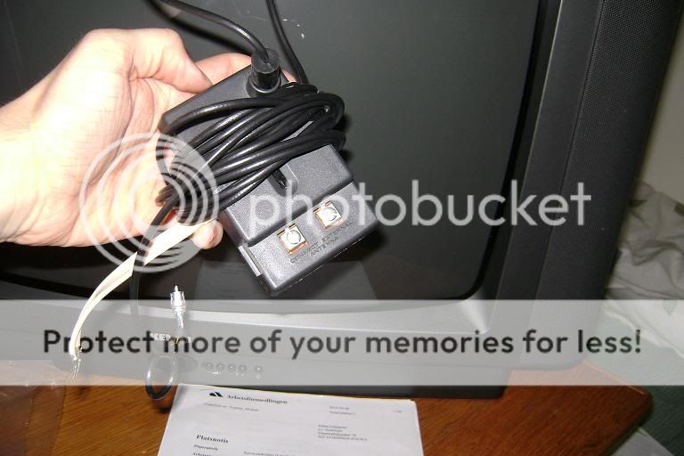

The antennacable

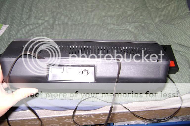

The rear of the system. I wanted to put the RCA jacks right beside the powerjack but the mobo is in the way so I have to put them somewhere else
