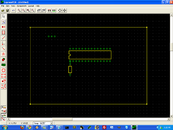

Working on PCB Design

EDIT: I have attached the current beta PCB Layout.
The image is off-scale, so don't waste your time building one yet. The layout is huge! theres more room to make it smaller; its just going to take some time to get it down to size.
I will include two PCB designs:
1. a layout that is now wider than the width of 2 ICs placed side by side
2. a layout for general purpose project enclosures (larger than the 1st)
« Last Edit: January 28, 2011, 07:30:24 PM by FOOKz »
