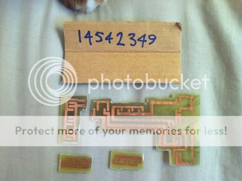

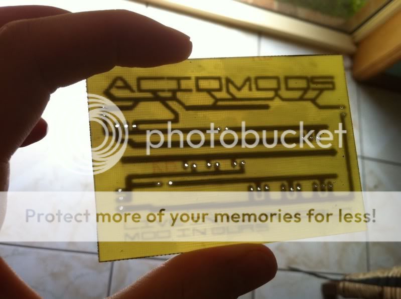

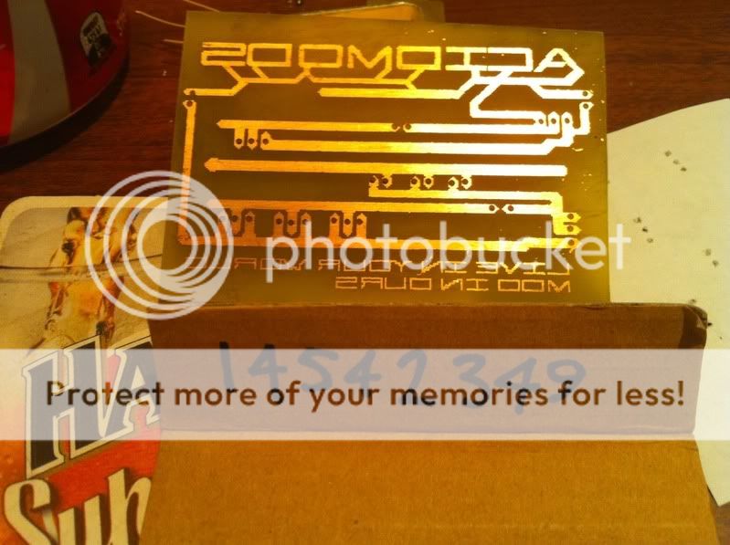

I etched this PCB today
Ta da!
ill be using this board to manage all the fans and LED's. this way if i want to change out a fan or set of LEDs i just unplug them and switch them over.
the headers im using are apparently UV reactive, so they glow when under a UV light, we will see how that turns out.
the AM logo is part of the 12v line, ill have LED's behind the board shining through so its visible.
almost forgot the all important number!
still waiting on parts, so thats all for a few days.

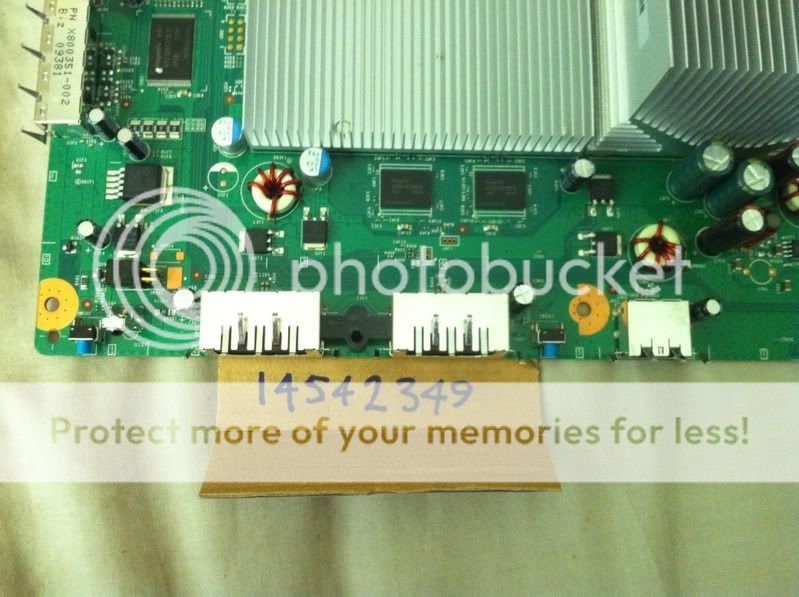

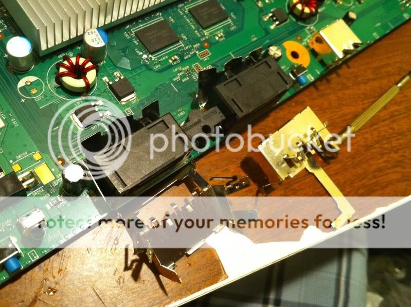

Here's some pics of removing the memory card ports, these things are a :censored: to get off the mobo. I had no luck in trying to desolder them, the solder just wouldnt melt. brute force took care of it.
the ports are now trash.
i slipped with the screwdriver and this came flying off.
im not sure if it would even be needed without the ports in use, but i thought id show off the iphones camera  :w00t:
The ports are 3.3v USB so im considering hooking up a usb drive to the pins, and have extra internal storage.
so now the ports are out of the way, there is room to fit the next part of my project.
I have a few ideas for the case, but i want to get all the internal stuff done first. im waiting on a USB hub so i can continue, so thats all for now.

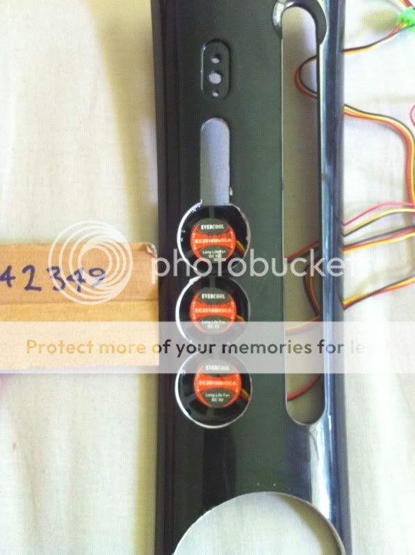

A new mod!

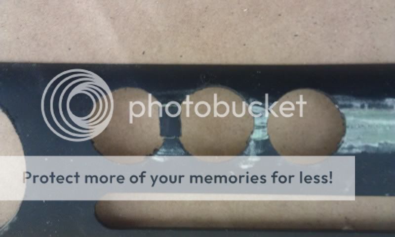

I did this on a spare faceplate i had, just to see if it will all fit, and get an idea of what its going to look like, none of the fans are mounted in yet.
still deciding on what to do with the ROL. i might put a player LED in each fan, it would give it a good effect on startup.
yep it looks terrible i know, its just to get an idea of how it will fit. Im going to fill in the memorycard ports before i drill the holes on the next one, so its just 3 clean holes without the gaps in between.
Those 3 little 5v fans push alot of air, its going to lower the temp of the gpu a fair bit.

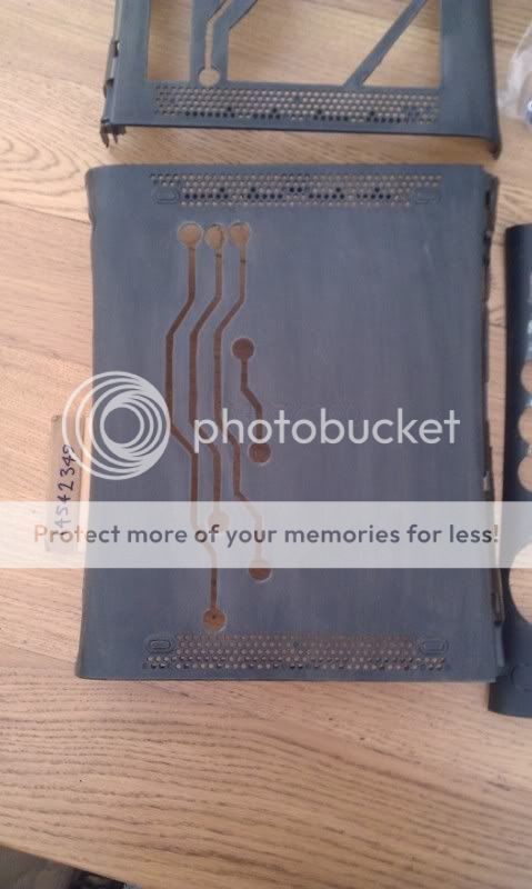

Im still not finished sanding, but here is the case so far...

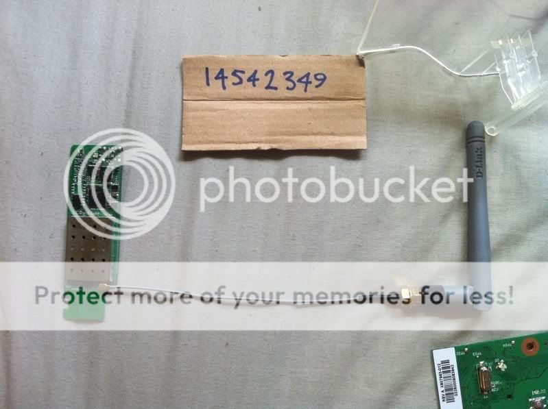

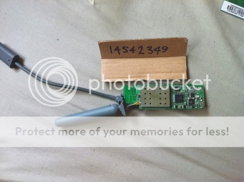

well i was going to wire up the wifi adapter internally, or so i thought.

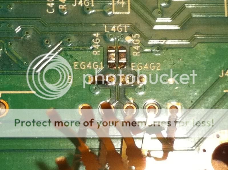

I made an attempt at removing the tiny bicolour led, and ended up destroying a smt resistor/something above it, obviously it was important as the wifi adapter no longer works.
so.
Im still going to wire up everything as i would, so when i get around to buying another wireless adapter (probably after the mod off) i can just swap out the dead one. the actual board from the adapter is connected by miniUSB so its just a matter of swapping them, no soldering.

nice cat.
can you take a close up pic of the broken motherboard of the wifi adapter because that can be an easy trip to radioshack to fix.
Offline Phantom
  • Posts: 355
  • Post quality +11/-1
Re: Mod Off Entry 14542349 - xbox 360
« Reply #12 on: March 24, 2011, 07:51:55 PM »
im not sure if it would be an easy fix, the parts didnt have any markings on them so i wouldnt know the rating.
heres some pics i took before hand, the 3 parts in the square would need to be replaced.

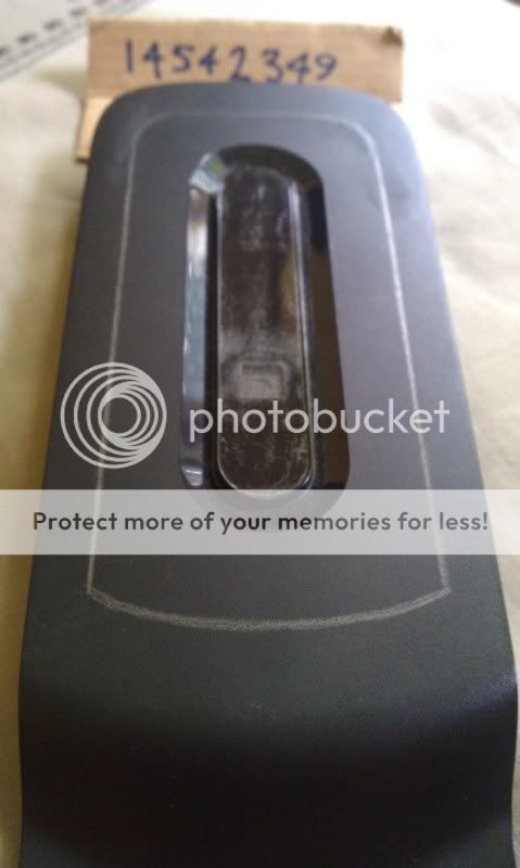

first cuts before sanding
im thinking white case, with blue lighting behind the 'circuit' designs.
its getting there! let me know what you guys think of it so far

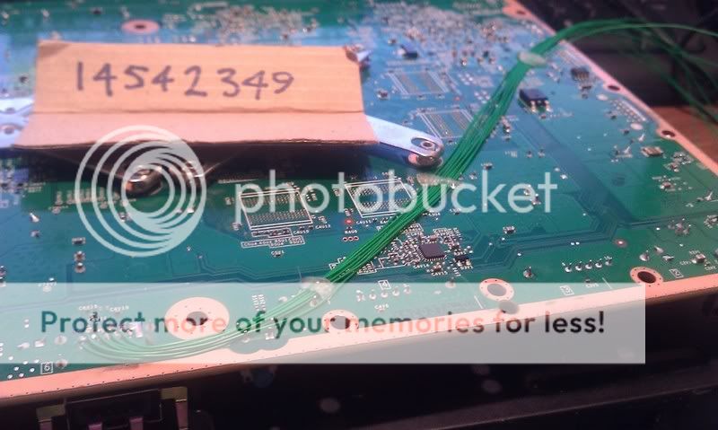

Nearly finished up the faceplate, just needs to be painted and have the fans mounted in
heres the wires extending the ROL.
i was trying to add another LED to the player1 LED and somehow ended up inverting all the colours to red? thought it had RROD when I turned it on...

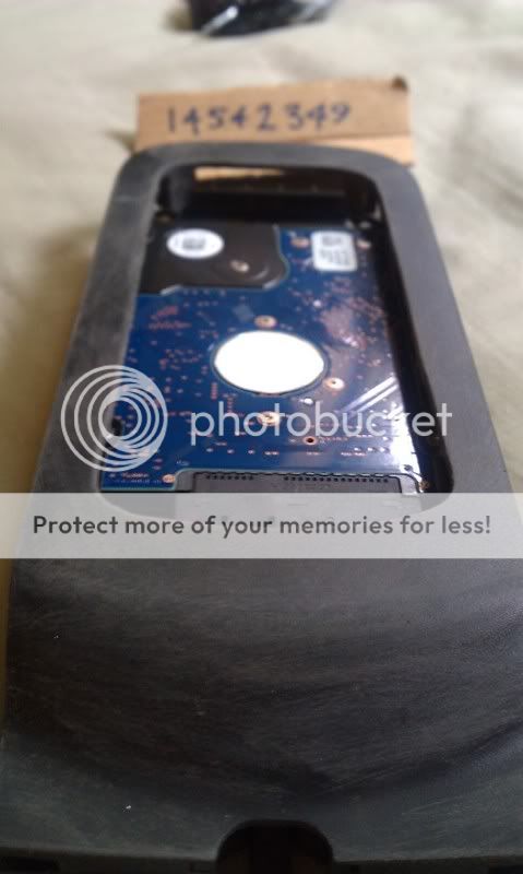

everything painted
I flush mounted the acrylic into the HDD, I think it turned out pretty nice.
faceplate fans
Still have to paint the dvd drive, do all the LED's, cut the acrylic for the case windows, then assemble it back together.
