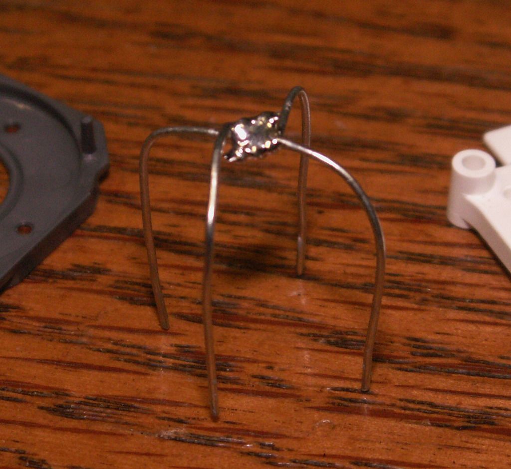

Now, if you've seen the above mess before, you already know about the Spring in there, if not and you're tearing one apart, you will, and too get this thing back together without losing the rest of your sanity you'll need to make a 'spring tool' or it just isn't going to happen.
You'll notice the Top and Mid sections of the Slider casing have 4 holes in it, so does the bottom but those are for the 4 posts that hold it all together. The 4 holes int eh Top and Mid sections were the same holes used during it's original assembly to keep the Spring open until the mid section of the case was in place.
I used the leads from a couple of 1/4W Resistors and just soldered them in a + pattern to make the spring tool. An old paper clip or two would make a better one as the leads wouldn't bend as easily...
...which gets inserted into the top part of the case.

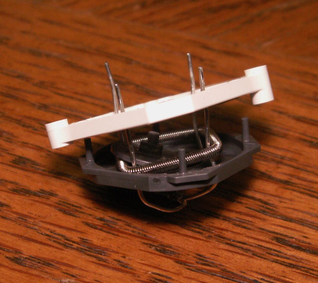

After that, you can install the Actuator and the Spring around the 4 'posts' of the tool.
Next the Mid section of the case needs to be installed. It makes no difference which of the 4 directions it can face, just make sure the flat side goes against the spring.
..then make sure the Actuator is centered up and press the Top and Mid sections together.
After that step the spring tool can be removed, and the hard part is done with now.
