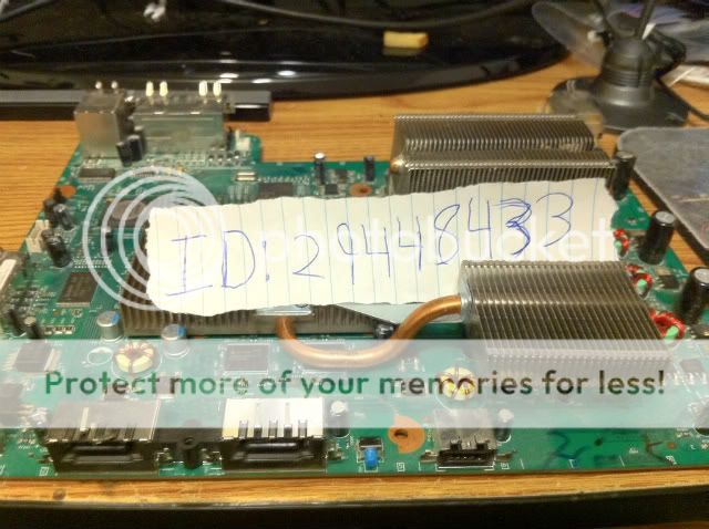

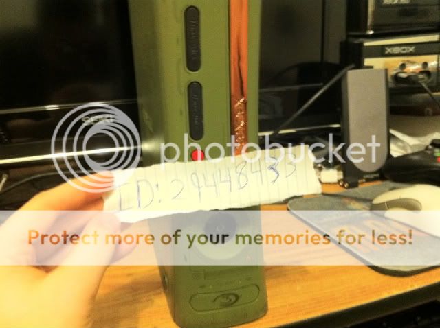

Ok so my first update will be showing my xbox 360 halo 3 edition that I bought from a friend of mine so I could try and fix its RROD (and yes its striped down of all mods) so after I did fix that xbox it kept RRODing on me unless I had a fan on it at all times. So I got the new xbx 360 slim and kind of just let this one collect dust for awhile... until my friend recommended that I join this winter mod off. So without further ado here are some pics that are unboxing/prep for when more parts I have ordered come in.
I needed to extend the ports on the xbox so instead of de-soldering them from it I took an old broken 360 and used those

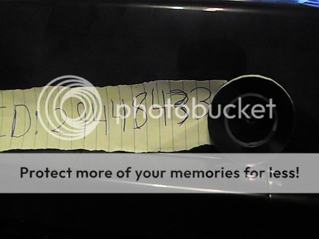

here are the ports
then I started soldering wires from the removed ports so I can solder them on the working 360 later when I get more parts so I can have exact measurements for wire length
oh and this account was created perfectly timing wise because I just got some parts in the mail today
still ordering parts so it may be a few days until the next update

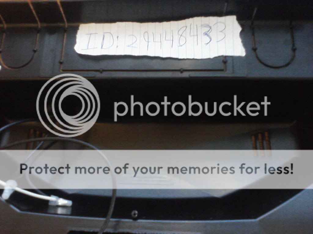

may i ask why theres gum in the last picture lol
Offline Coincidence
  • Posts: 7
  • addicted to LEDs
Re: ModOff Entry 29448433
« Reply #3 on: February 17, 2011, 05:48:46 AM »
lol just to show the size of the radiators

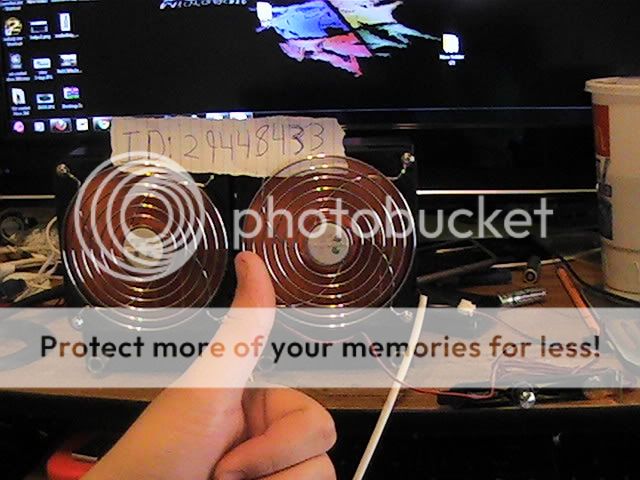

Offline Coincidence

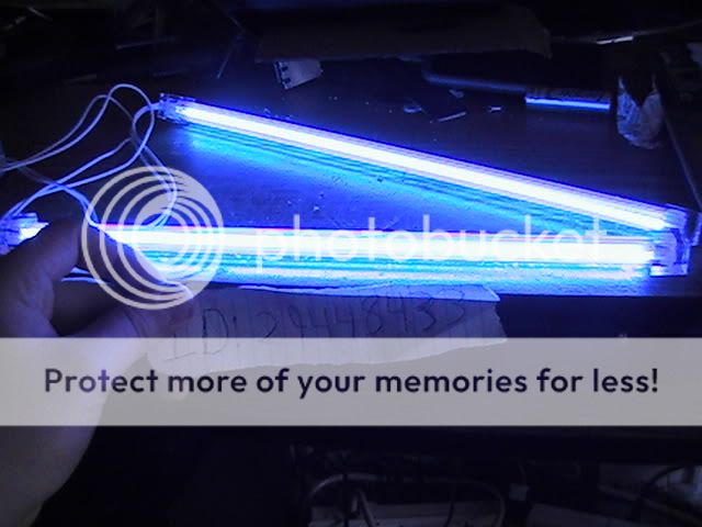

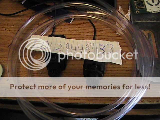

Ok ACT is finally over and I just got almost everything I ordered which means that I wont have to buy any more stuff beside last second stuff or stuff at a store :D

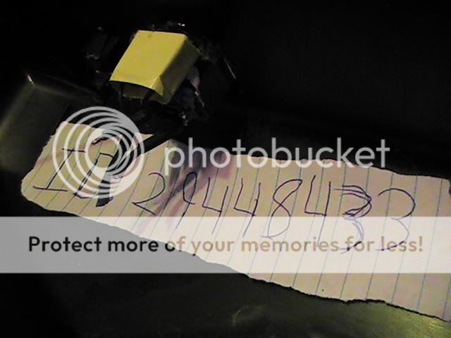

here is the 2 CCFLs I got, the tubing, and the pumps which were waaaay smaller than I expected but they should do the job as there water/oil pumps lol

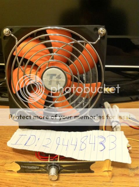

after that I started working on the radiators because I really didn't want to dremel 2 spots on the hood for fan control so I made one that controls both the radiators fan speed

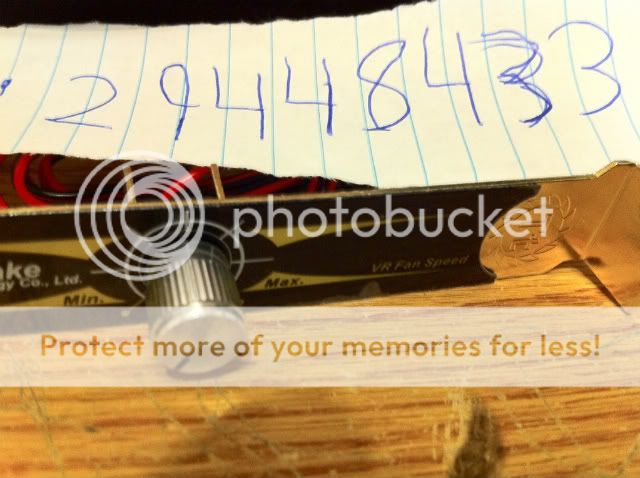

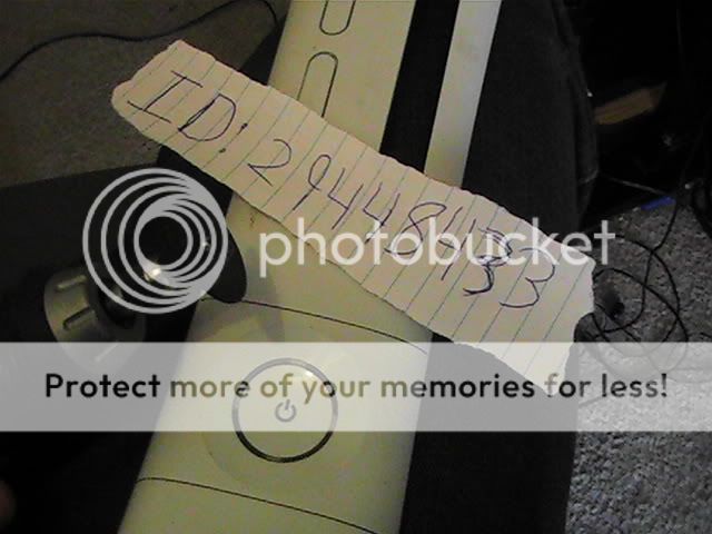

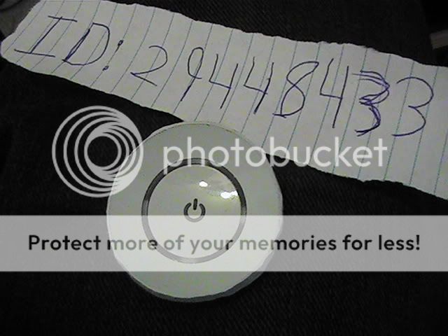

then I worked on getting the ROL ready
I made it so I had to cut it in sections, first a large section,
Then after doing all I could with the rotating blade...
I switched to the grinder, and it came out like this
I also got some paint from a friend today
so I tested it on a chunk of whats left of the faceplate to see if it would blend in with the hood of the fish tank well
after that I painted the ROL,
It matched pretty good idk if I will have to paint the hood too but well see,

so heres the ROL button in the case
outside view..
here is my ghetto rigged support system for the ROL board so the button could be pressed
and here is the board fully installed in the tank hood
I should be getting the mounting piece sometime next week so after I can start soldering to the mobo and get this mod finished :D
