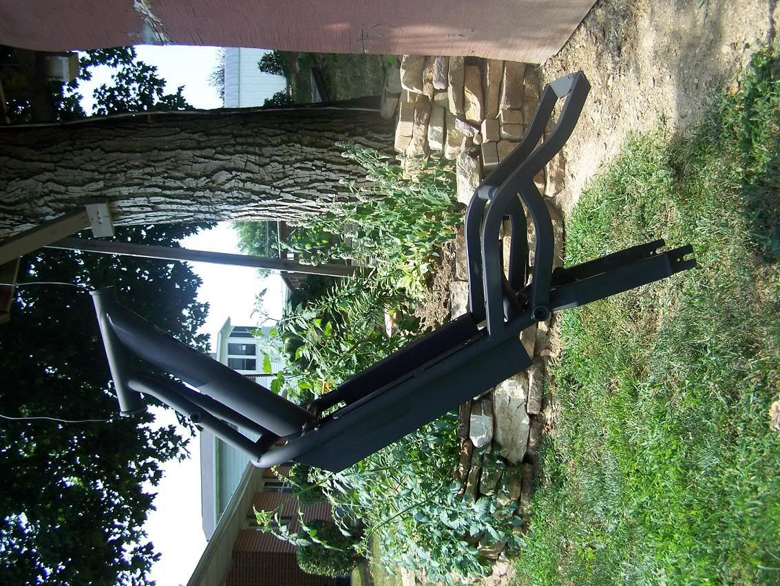

« Reply #10 on: July 20, 2011, 12:49:34 PM »
« Last Edit: July 21, 2011, 06:11:56 AM by FOOKzâ„¢ »
Re: Scooter
« Reply #11 on: July 20, 2011, 01:27:49 PM »
LOOKING Good no need to bump ....lol needs another coat and wet sand between coats

I haven't taken pictures after the second coat of color and the first wet sand yet. will take more tomorrow. I might go out and grab a couple cans of silver just like you said.
