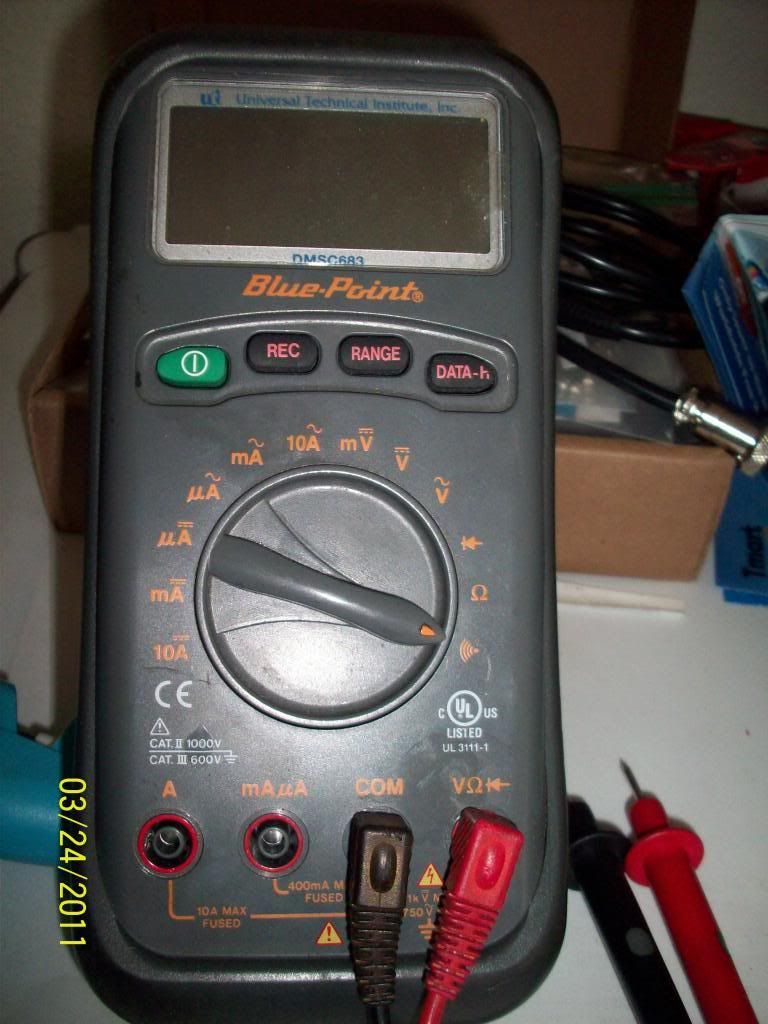

this is the meter I got went I went to mechanics school, it's labeled "blue point" (which is the 'low end' snap-on branding) but it's actually a basic auto-ranging Fluke meter that's just re-branded for snap-on. I was required to have one before starting school and this was the one they were selling and it was actually comparably priced at $100 (it was actually about $20 cheaper than the fluke version at the time)
the range button turns off auto-ranging and lets me select the range if I want to...
