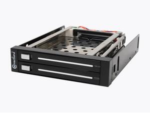

New plan. Removing broken BR drive. Going to work on some sick stuff for in there. Found some sweet lil parts for the mod. Ill post some stuff with pics later. But I found a raid 0,1,etc 2x sata2.5" usb HDD enclosure. Thinking about that or a usb media card bay w 2.5" stata drive bay. I don't know yet. I have a whole liquid cooling system sitting around , I might liquid cool this beast. I'm up for suggestions.  Actually I could use some help deciding on which way to go with the mod?
check out this trick lil device. put this inside the lil cover where if it was a 60 gb would have media card readers.
Maybe this too.
BYTECC BT-M251-BK 2 x 2.5" Black USB2.0 & eSATA Drive Enclosure for SATA HDD/SSD, with RAID Switch
 I think If I wanted to do a raid set up it would be raid sata to sata , not usb.
ie: more internal ps3 storage.
Or put this in the drive bay instead. I kinda like this one. And then find a raid setup for the internal drive. Akasa BayMaster Card & Drive Reader 2.5” SATA HDD / SSD Drive Dock
Last find I like this one too.
NEO I-NA205Ue2 Aluminum Alloy / Plastic 2.5" Black USB2.0 & eSATA External Hard Drive Enclosure
please thoughts?

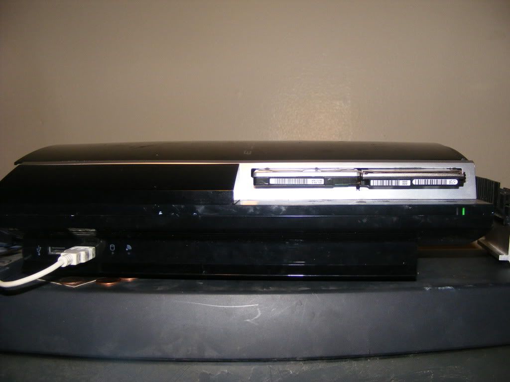

Final answer here . Dual usb 2.5"sata drives mounted exactly where the BRrom was. Here is more mock up picks. I am really liking the way this is heading.
  • Posts: 1224
  • Post quality +47/-2
Re: My new Ps3 Lighted case mod.
« Reply #6 on: April 11, 2011, 04:58:07 PM »
So the plan is to buy 2 of the largest 2.5" hdd's i can find and hook them up through usb internally . 1 drive for My insane movie collection. The other for games. not raid. so i did some cutting today. These drives are just for mock up.
What do you think. I might try to find a second cover like the one on the left side of the ps3 to cover the drives.
« Last Edit: April 11, 2011, 05:02:04 PM by denali31004 »
I pray you're going to cover those up.

this is just mock up. the drives slide into a sata usb tray. I want to find a 2nd cover like the one on the left and put it over the drives. I left them sticking out so i could remove them by hand.

The Ps3 is on CFW. Only way to play anything on this PS3 is from HDD. The BRdrive went in a fall.

Yeah i agree, having drives randomly popping out of there isn't ascetically appealing. That would be pro if you could pop those suckers in there any time you had to like 160GB SD cards except they're hard drives lol.
  • Posts: 1224
« Reply #12 on: April 11, 2011, 07:02:16 PM »
FOOkZ They are hot swappable on usb. They show up as usb device 0 and 1.
« Last Edit: April 11, 2011, 07:03:00 PM by denali31004 »
Offline FOOKzâ„¢
« Reply #13 on: April 11, 2011, 07:09:16 PM »
Wait so you could like hook up 1000 hard drives if you had enough usb hubs?

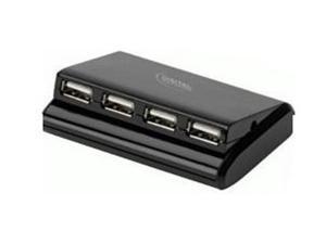

I made this clip this morning. This plugs right into the BRdrive power. This is so I don't have to modify my original BRdrive power harness .
Here is my work starting on the USB stuff. My daughter this morning broke my SD card reader , So I am going to internalize that to.
The last pic shows the USB hub stripped of its USB sockets. I am going to use MOBO style USB clips to connect to internal devices and USB sockets. There will be 4 front usb sockets and 1 rear.
Internal will have 1 SD card socket. 2 internal usb sata HDD's . Thats 8 USB slots. 2 hubs. 1 HDD per hub. 2 usb sockets per hub . and 1 hub will handle rear usb, while the other hub handles SD card. I know it makes things harder dividing the sockets up this way , but its the only way with the hubs I have to get both HDD's to be recognized at the same time. The rear USB is for my move camera. Also there will be some funny stuff going on with all the LED's for the different devices. Each hub has its own LED. I will use these 2 leds to back light the front usb ports . The HDD LED's will be connected to a RGB led. and depending on what hdd is working will light up accordingly . So when coping from USB HDD to internal HDD you would get a purple color. RED and BLUE. etc.

that rgb activity light is awesome! but won't wiring the data lines of the HDDs together cause problems?
  • Posts: 1224
« Reply #19 on: April 21, 2011, 05:51:17 AM »
Thanks Hyper. I'm not wiring the data lines together. I am internalizing 2 hubs. I am putting one drive per hub.

I meant here for the activity LED, i'm probably wrong but i assumed this meant wiring the sata data lines from the hdds to the led so it flashes with activity....
« Reply #21 on: April 21, 2011, 07:55:36 AM »
wheres the rest of the picture .... :)....lol
  • Posts: 1224
« Reply #22 on: April 21, 2011, 08:35:41 AM »
Oh . No sorry .should have maybe put more details in about the led stuff.I'm using 2 external usb sata hdds internal they each have they're own hdd activity light its built into the board for the usb/sata adapter.
