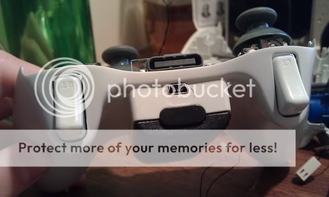

OK, guys, This idea was something I had considered for a while now and thanks to interest from drummerdude and Anonamous, I was finally prompted to actually do something about it. I've been working on this one for a few weeks now, trying to get the bugs worked out, and I finally got it working properly. So I present to you the On-Board CG1 SOIC 12F683 install:
Now, you may be asking yourself why you would even want to attempt this, well lets compare the SOIC 12F683, the PDIP 12F683, and the PDIP 12F683 with a socket:
Now, if space inside the controller is important to you (for whatever reason) you can see how much space this chip can save you...
First things first, this SOIC footprint is only on the CG1 controllers, and you have to cut the traces that lead to the footprint in order to be able to use it for this, but you need to be very careful and very precise in cutting the traces so that you don't affect the controller's normal operation.
Second, there are two pads that once cut loose will kill the sync on the controller as well as make the analog sticks and the triggers act funky, do not miss that step.
Third, be extremely careful when placing the chip and soldering to the footprint so that you don't cross pins or wires (very easy to do considering the small amount of space you'll be working in), or lift a pad (it's not that hard to do).
OK here we go:
First, scrape the traces that lead to the pads. You don't need to clean that much of the trace since you really only need to remove about 1mm of each trace. Some of the pads have more than one trace connecting to them, you will need to cut ALL of them in order to isolate the pad. the ground plane connections are the hardest to remove (the ground plane is the large checker board looking sections).
Here is a pic of the traces surrounding the pad after I have scraped them clean:
Here are the pads and traces marked, Pads are in red, Traces are in Yellow:
See attachment at the bottom labelled 'Pads'
Here are the purple marks are where I removed small potions of the traces in order to isolate the pads:
See attachment at the bottom labelled 'Traces'
Here is a pic of the traces and pads after I have cut the traces, isolating the pads from the rest of the controller's circuits:
NOTE: There are two pads that once isolated the traces that lead to them need to be rerouted (The two upper right pads in the above pictures). What you need to do is find a close section of ground plane and scrape some clean till you have some bare copper showing, then tin that section and run a small jumper wire from the trace to the ground plane as shown in this pic:
See attachment at the bottom labelled 'Greenie'
After cutting the traces and rerouting, I used a soldermask pen (also called an overcoat pen) to cover the remaining bare copper of the traces and the surrounding resistors and other components, to prevent any shorts.
Then I soldered my SOIC 12F683 to the footprint, making sure that the chip was fairly straight and well centered on the footprint (chip orientation doesn't matter I've installed with pin 1 at the top left and bottom right pads in the above pictures).
Right now you may be saying "wait, you didn't program the chip!" Well if you have the proper tools and want to program the chip before soldering it to the footprint, be my guest; but don't forget in the future you may want to program a different code to the chip, and that would mean you would have to desolder the chip from the footprint and then you risk lifting a pad. So, what's the solution? Make a programmer lead... This is very simple and shouldn't take too long, here's the one I made:
So basically it's as simple as twisting 5 wires together and soldering one end to a section of pin headers, the only thing you need to know is which pins are which on your programmer and making sure you connect the right wires to the chip pins...
Here is my revised programming lead soldered to the chip and inserted in the programmer:
Once the lead is soldered in place, program the chip, and then desolder the programming lead.
Then all you need to do is follow a normal RF install. I prefer to use t0pfire, so here is what it looks like once everything is soldered in place (well minus the ground wire you need, as this was taken on my first attempt to do this mod and I didn't realize I left out the ground wire mentioned earlier):
