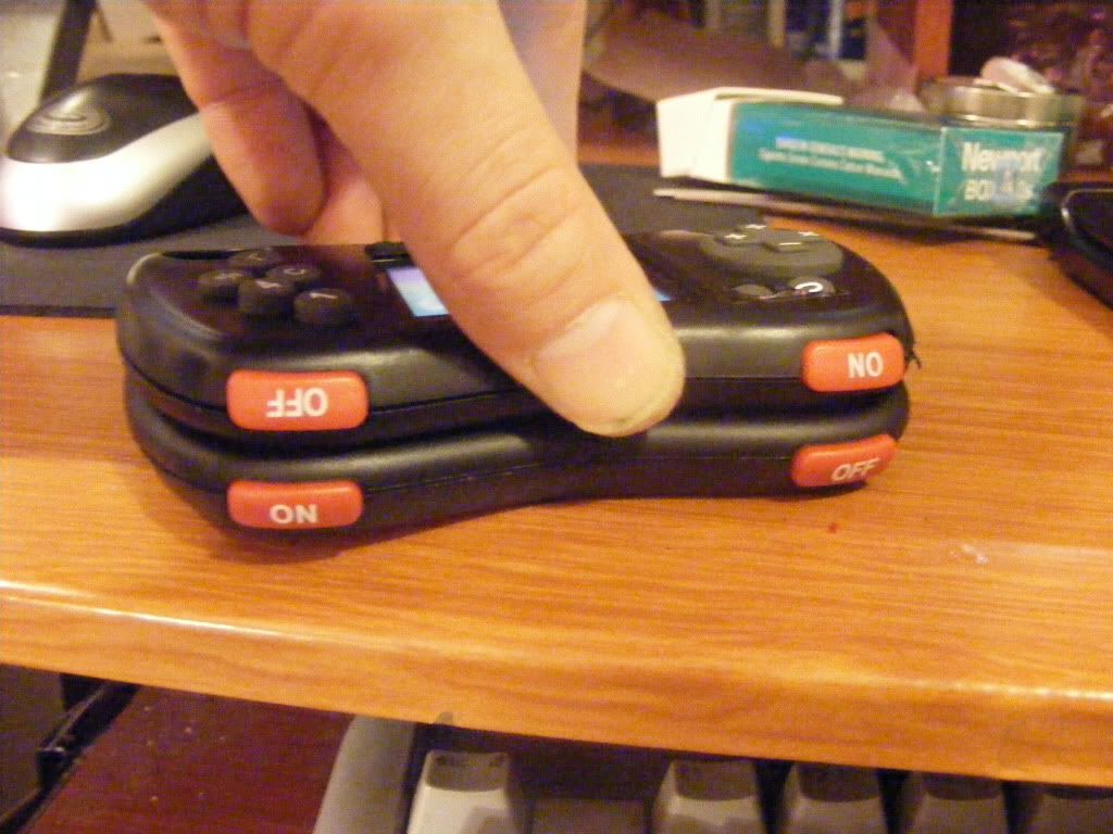

I went shopping today and threw some stuff together when I got home. I doubled the controller up. This served 3 purposes , 1 to allow room for full size analogs , 2 It let the mp3 player to go in , 3 it gave me 2 sets of triggers instead of 1. I added buttons for /\ , sel , start and home. I am going to be filling the gap between the 2 w clear silicone. Then I will light up the sides. might even go sound reactive... Next gotta look through and find an amp and some lil speakers. I think I may have something for this laying around.
The back side. these buttons will be for L3/R3
« Last Edit: July 03, 2011, 07:59:52 PM by denali31004 »

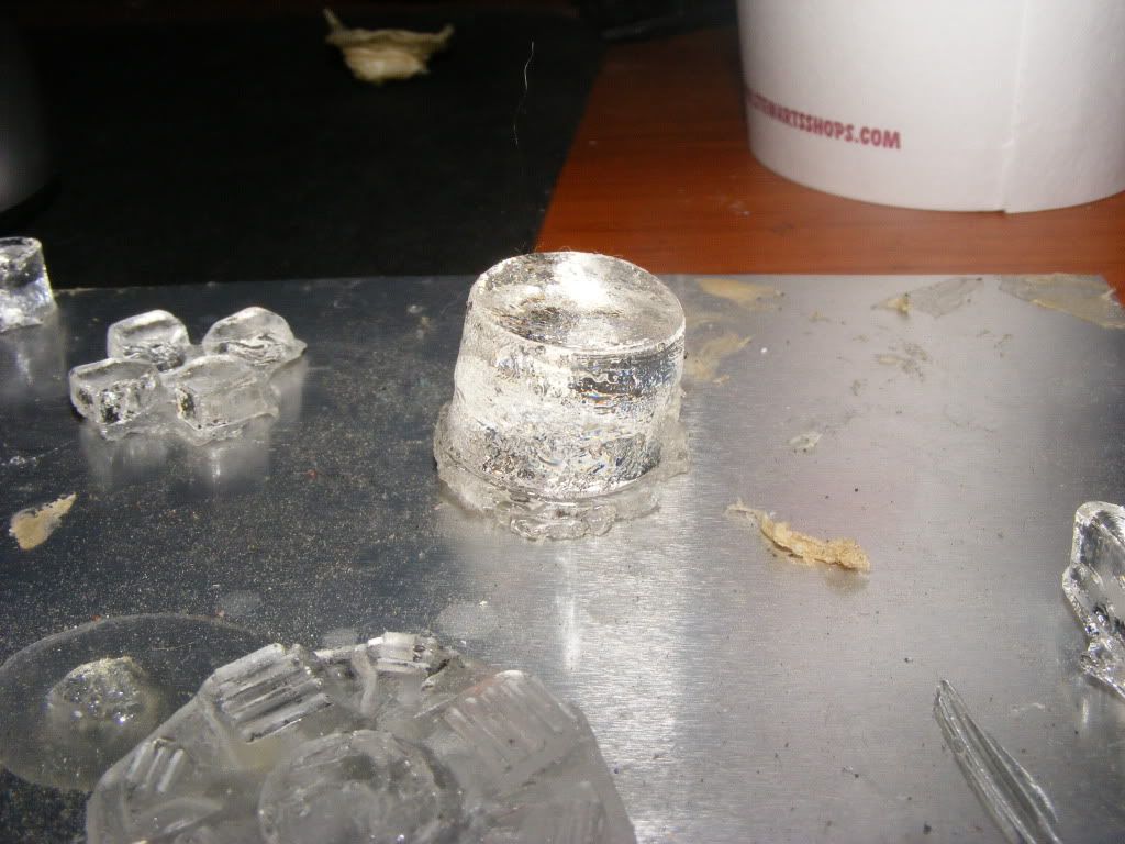

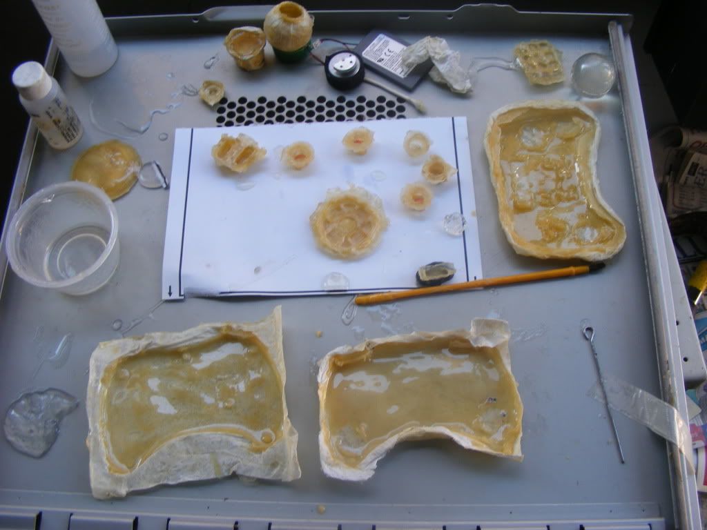

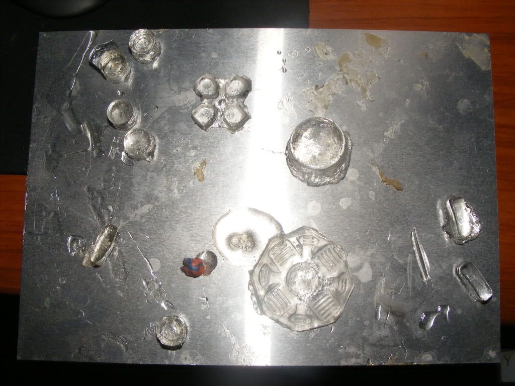

MOLDING
molds pulled...
« Last Edit: July 09, 2011, 04:22:53 PM by denali31004 »
