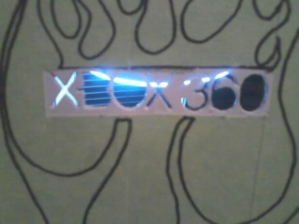

                                       FLAME MODDED XBOX 360

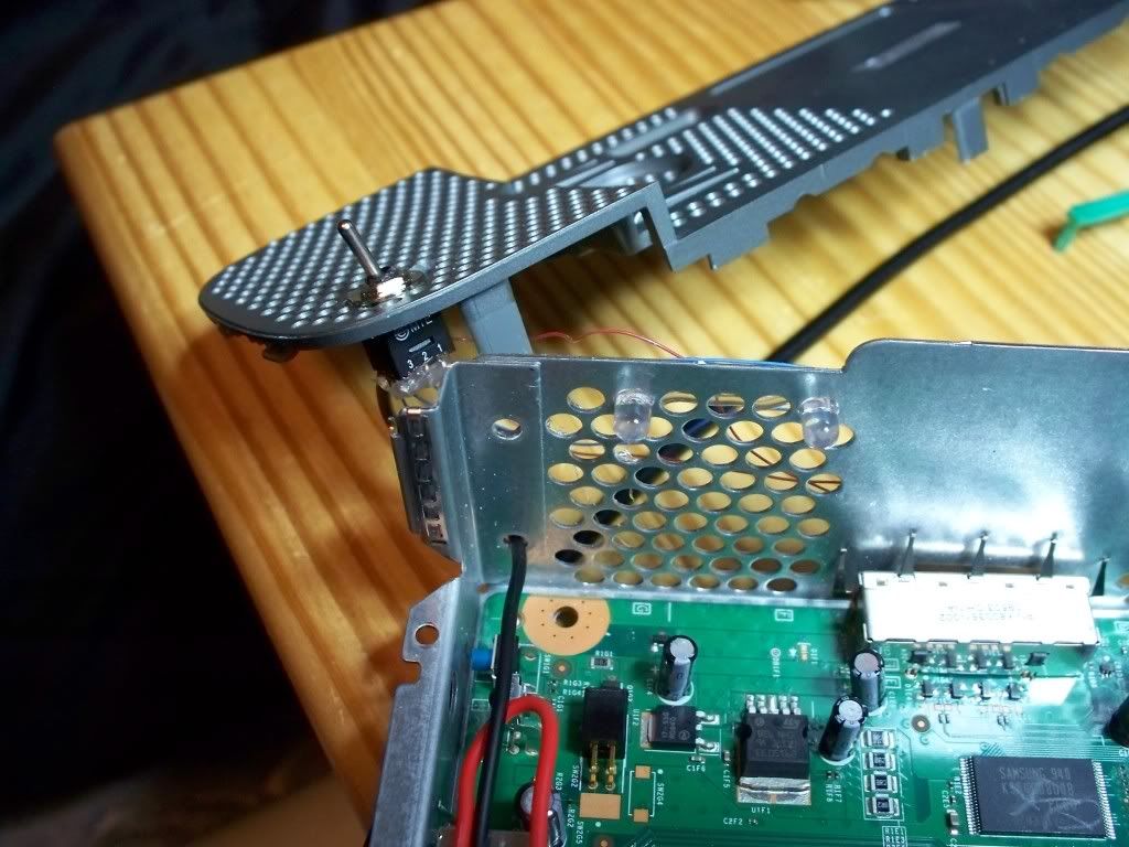

 PARTS NEEDED

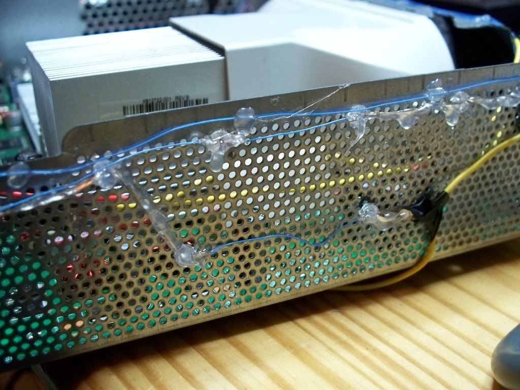

                  8 RED 5MM LEDS
                  6 ORANGE 5MM LEDS
                  6 YELLOW 5 MM LEDS

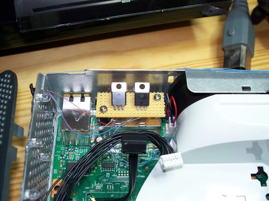

                  2 TIP 31 Components
                  1 DPDT Switch
                  30 AWG Wire
                  1 PCB Board
                  2 MOBO StandOffs
                  1 Molex connector male and 1 female Molex connector
                  14 Gauge wire for the Molex connectors

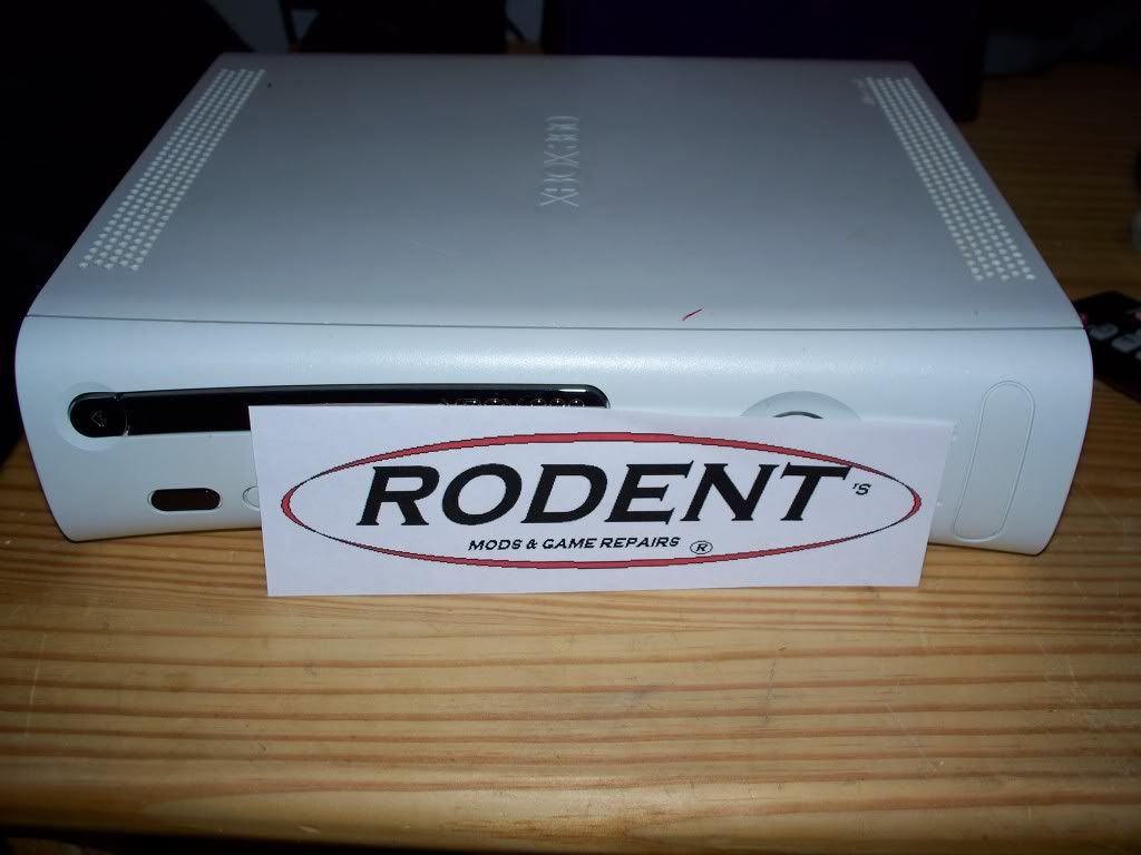

Regular XBOX 360 Pro
Here it is finished and in action
http://www.youtube.com/watch?v=CI3yUY1q-Eg

For anybody wondering where the AV cable pinouts came from, they came from xbox-scene.
It looks good Rodent, only thing I'm noticing though is that it appears that the led's are a little-bit off beat with the sound.
Re: WORK LOG SOUND ACTIVATED FLAME XBOX 360 MOD.
« Reply #11 on: July 17, 2011, 08:35:24 AM »
Thanks Anonamouse, for mentioning where the AV cable pinouts came from, i totally forgot where they came from. thank you!
 And ,theres a little secret to the reason its off beat, not all the leds are on the same audio out put, the top part is to one side of the left audio and the bottom is to the right side of the audio , if you watch closely you will notice that the bottom flickers like the flame is starting and then the top lights took me a few trys to get it right.
Edit: thats why I used a DPDT switch and not a SPST switch, and 2 tip31 components for left and right audio.
