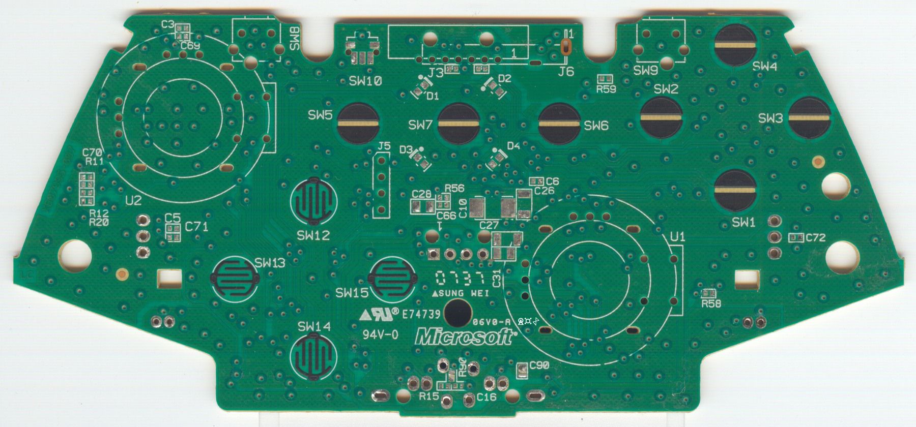

can this be fixed
« on: July 15, 2011, 08:53:43 PM »
some idiot tried to i guess have sex with it

« Reply #1 on: July 15, 2011, 08:55:16 PM »
Ive had that problem countless times. Just follow the trace all the way to a solder point "hole" and solder a piece of 30awg wire from the pin to the solder point

here are some pics after it is cleaned a little more
Re: can this be fixed
« Reply #5 on: July 15, 2011, 10:20:20 PM »
what kind of board is it  ? so i can find you the traces

« Reply #6 on: July 15, 2011, 10:28:57 PM »
its a cg
« Reply #8 on: July 16, 2011, 05:12:56 AM »
The middle leg is the important one, the outer pins are vcc and ground. All you need to do is run a lead from the other stick or another ground or vcc point, as I don't remember which is which, but that info is onsite somewhere.

« Reply #9 on: August 10, 2011, 06:42:35 PM »
i havent tried to do a repair yet on it. but when it is tight and not moving it doesnt shoot. pretty has something to do with the middle pin.. but when i mash start and go back it shoots?

« Reply #10 on: August 10, 2011, 11:14:08 PM »
yes, 1tonpete is right. I fixed two controller with this problem. The upper point is analog voltage (TP8) and the lower is ground (TP2 or TP22)
Hope this help
« Reply #11 on: August 11, 2011, 09:25:56 AM »
thanks. i will try it to do.. just run it to the other side point on the left triggger? both or just ground?
