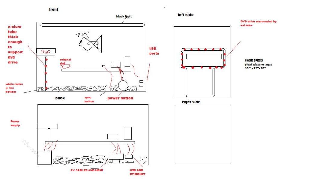

here is what i am doing but with an xbox
Mineral oil computer

Yeah just a parts list and i dont really get why you need 2 xboxs.
Maybe a diagram on how you moved your power button ect would help thanks.

« Reply #15 on: January 14, 2012, 01:28:58 PM »
um well the way I did it is use a heatgun on the board and pull on the port with pliers until the heat melts the solder and the port comes off, then just run wire from the board to the port so it will extend to the hood on the top, I used 2 xbox's because when I did use the heat gun on my old mobo it was flexing like hell, so idk you can just let it melt until the port comes off really easy just make sure not to burn or melt the board or chips on the board
you will also need a dremel to cut out the holes in the top hood (do all the cutting before you mount the motherboard on the back
here is the rest of the parts,
2 12" CCFLs (pick a color)
http://www.ebay.com/sch/i.html?_from=R40&_trksid=p3984.m570.l1312&_nkw=dual+12%22+CCFL&_sacat=See-All-Categories
some sort of acrylic so you can drill into it and mount it on the case with epoxy, then screw in the mobo
fish rocks (clear rocks like i have pretty much just in the crafts section of walmart
and finally a power supply, I got a 250W one out of an old computer, try to get a smaller one (size wise) so it will fit nice in the tank
I think that's about it between this and the last post that should be everything
