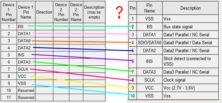

Hyper thanks, I was hoping you would see this.
Well here is what I got...
« Last Edit: January 30, 2012, 04:43:27 PM by 1TONpete »

That looks good and all the VSS's would just be connected together

Thanks hyper any ideas on pins 10 and 11 on m2?
reserved so that basically means not in use now but might be needed in the future if they made like "M2 superfast version" or something like that. you don't need to worry about them.
