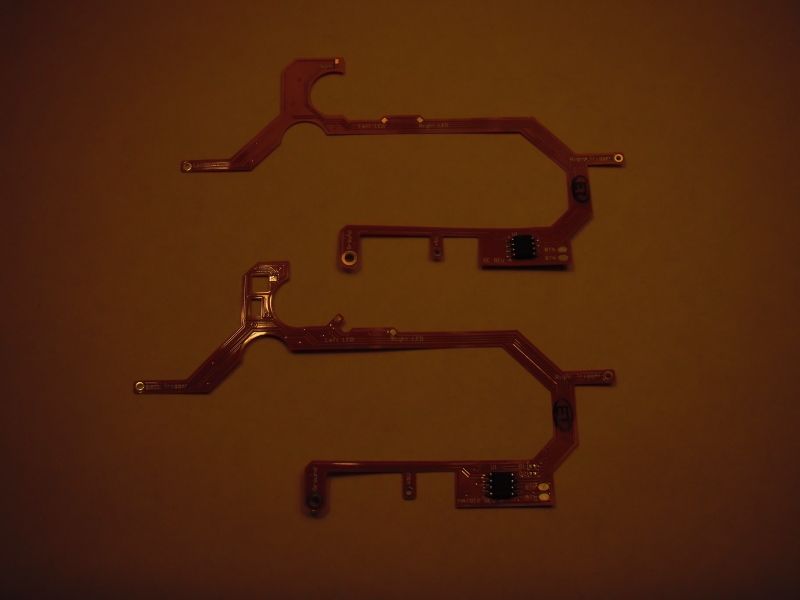

Below Are Few of Felx Board For Xbox 360 from 2008 Till 2012,
Flex is not Cheap and if you pick the righ Electronic Component Packaging type you can Assemble by hand with steady hands.
IF you Use (QFN) Packaging Like I have to save Space than Its best to have them Asssemble at Factory.
The Born of Flex Xbox 360 CG / Matrix
Cg/Matrix With Switch select
CG / matrix  Auto Select
Final
Final With light
And The Big Daddy With All Adon
