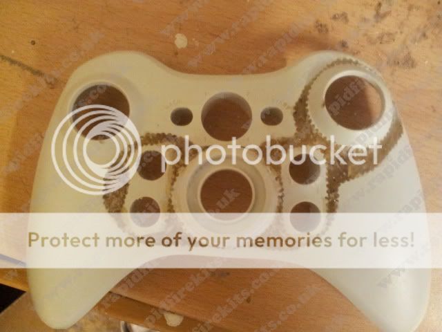

Heres my current work in progress, i was sat there one day, looking at the controller in my hand and started to think of this modification. Why do we stick with convention? What happens if we go back to the drawing board and start from scratch?
My main aim was to achieve a "stock" look.
I'll let my pictures explain my work.

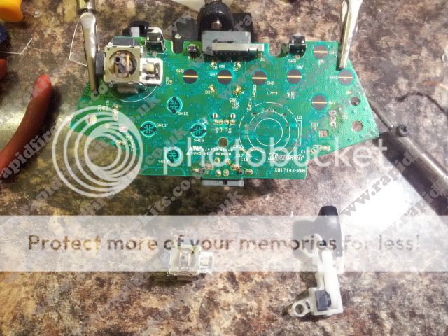

I know exactly what im doing for everything except relocating the D-Pad. Whats everyones thoughts on this, im unsure of exactly the best way to do it?
The plan is currently to butcher an old CG motherboard and cut out the D-pad to create a daughter board. Then simply move this over to the redesigned controller and begin to wire it up as standard. The only issue with this is it would create an extra 5mm of hight at a guess and then id have to modify the D-pad itself. Not an issue but if anyone has a better idea be sure to let me know ;)

Yeah that can work, I'm doing that for my controller redesign. For my first redesign, I simply put some tact switches on breadboard and had that underneath the dpad.

What too did you use to make those perforated lines, some hot poking tol?  I like how easy that tools makes that job, and it looks very clean.  I like the symmetry of the control, but idk about the functionality of having to take both thumbs off the analog sticks to push buttons now.  And if you use the stock ABXY buttons, idk if the letters will be right-way up since you rotated the housing for them that they line up into.

Nothing any where near as complicated as that i simply used a drill with a bit that was 1.5mm in size. If i was to go back and do it again id even go as far as 1mm or possibly .5mm after that it was simple work with an Xacto Knife and little to no mess with 0 plastic melts.
As for the buttons im going to sort out new notches so that they sit strait im aware that they would be all over the place. In terms of the location they feel really natural once its in your hand. But i have no idea what hole im going to use for what button yet.

whats the product called that you used to fill up the areas? you mentioned something about 0 plastic melt, is that whats it called? and how hard isit to use it?
thanks

I used hot glue to achieve a basic attachment.  Then moved onto car body filler and added strength to the glue that's there, any brand will do just make sure to get easy sand stuff as you'll be at it for ages.
No "0 plastic melt" refereed to when your cutting something out with a rotary tool for e.g. a dremell i often find that it melts the plastic slightly while cutting. Using a drill with a small bit eliminated any of that.
Car body filler is really simple to use. You get a hardener and the product, mix them as suggested and apply to the area. Be sure to cover the area but don't overfill. As then you have more excess to remove through sanding. Allow the set amount of time for it to harden. I wouldn't recommend using a sanding tool on a rotary tool, your best bet is to simply start with a rough grit sand paper and work your way up to 1200.
Hope all this helps

Thanks For the Quick reply, i really appreciate it.
I used something today that i found at a hardware shop, some kind of putty, but it was quite hard to use, the putty doesn't stick to the plastic, and it keeps caving in, (if you follow what I'm saying). I'll try and find some Car body filler then. Thanks for the help.
And yes this helped, a lot :P!
