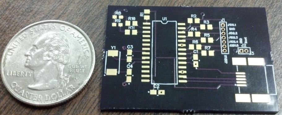

« Reply #34 on: January 31, 2013, 11:05:42 AM »
that's what i have for a parts list
let me know if this is correct.
R1 and R7=10k ohm 1/4 watt resistor size 0805
R2,R3,R4,R5,R6=100ohm 1/4 watt resistors size 0805
R8 and R9=led's size 0603 any color
R10 and R11=100ohm 1/4 watt resistors size 0805
C3=0.1UF size 0805
C4=0.47UF size 0805
C1 and C2=22PF size 0805
crystal is a 12mhz crystal
5 pin usb connector
18f2455
and a way to program that 18f2455 (pickit etc)
« Last Edit: February 01, 2013, 12:03:38 AM by theodor613 »

Re: usb nand reader
« Reply #35 on: January 31, 2013, 12:58:02 PM »
https://www.acidmods.com/forum/index.php/topic,40528.0.html
If you need help let me know. I have made a handful of these myself lol.

Re: usb nand reader
« Reply #36 on: January 31, 2013, 02:27:50 PM »
thanks anon pretty much a smaller footprint added connector to be able to flash hex files while the soic is soldered on and added leds also
ready to be uploaded to oshpark to get them made
will uploaded a parts list in a bit

Re: usb nand reader
« Reply #38 on: February 01, 2013, 06:50:00 AM »
I don't know if you have it in the gerber files but from looking at the picture in the first post you are missing a connection. Pi 23 on the PIC is supposed to be connected directly to J1D2.4
Offline 3D0kassiah
  • Posts: 809
  • Post quality +19/-2
Re: usb nand reader
« Reply #39 on: February 01, 2013, 07:17:33 AM »
the picture in the original post is outdated i redid it a few times with the help of RDC
Tracey: f off Rodent

Re: usb nand reader
« Reply #40 on: February 01, 2013, 10:43:25 AM »
i was reviewing both the first board and the final rev. i also spotted that. it's all good though, a few of my friends wants to learn how to solder small components so i will be using these for their learning purposes. im looking into going to school as well so the first boards are gonna be my practice board for school.
