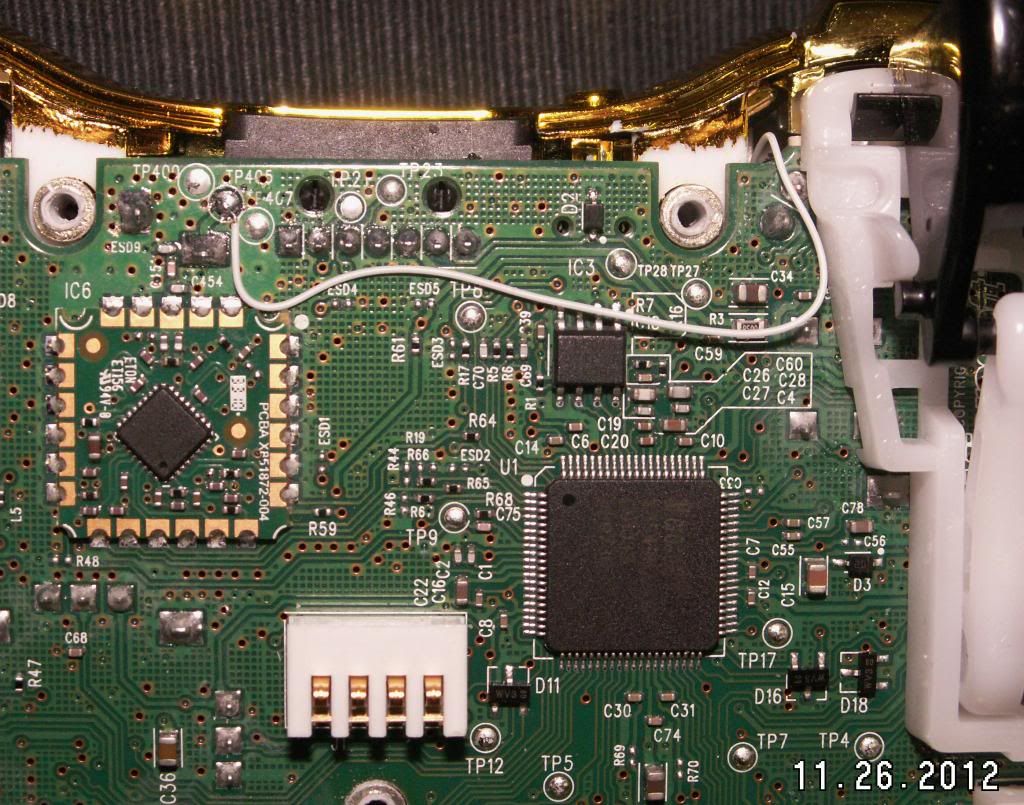

Offline KingMike_OS
  • Posts: 929
  • R&D
Re: Can you remove this metal piece on wireless controller?
« Reply #4 on: January 07, 2013, 04:29:48 PM »
yeah you can remove it and just solder Wire to the Point and Run it Under the Board or some where out of your way
This Fix is also What we use to Fix the range on the Gold and Chrome Case which the Paint Blocks the signal
and you have no range, This Will no Increase the Range of Stock Controller in any Shape Just Improve when using
after market case Like does cheap Gold and Chrome case.
Thanks To RDC for the Picture .
« Last Edit: January 07, 2013, 04:33:18 PM by KingMike_OS »
