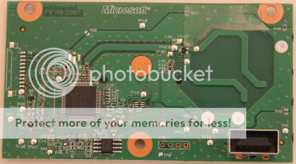

hi, I have been reading up on putting together a ROL Mimic circuit and realized that I have a RF02 version with completely different circuitry setup on the back.
Has anyone ever looked into similarities in pin outs?
Thanks Willy

please post pic of your rf board

I had an rf-02 board and didnt even bother trying to work with it lol, your best bet would be to try get an older board, the rf-02 is missing those transistors
http://pictures.xbox-scene.com/xbox360/jasperv2/STP67429.JPG
(not my pics)
« Last Edit: January 16, 2013, 09:21:07 PM by phantomz0 »

Would another RF board of older revisions work with this newer  phat HDMI 360?
Phantomz0 has a great photo of the back side of the board i have. but here is my photos of my board for the front side.

i dont think it should matter what board you use to be honest i could be wrong
but if there interchangeable im sure i can find you an older working rf board have some somewheres
i dont think it should matter because i had a bunch of rf boards at one point and i would mix and match between consoles none gave me an issue
can someone confirm
be more then happy to help you out if there interchangeable ill look for one tomorrow

yeah the older rf boards will work on the newer phat 360's, i just found those pics on xbox-scene they're not mine

I dug around my parts and found an older RF module, ill give it a whirl and see where i go with it. hopefully its smooth sailing from here. Thanks yous guys! Almost five years for me and the AM community is still always there for you.
EDIT:
So I have been using 2N3906 and ran into a problem.  When I sync and have one controller on, both P1 and P2 (xbox is horizontally) are lit up.  Having controller 1 and 2 on, P1 and P2 lit up.  With controllers 1, 2, 3 on I get all lights on.
@Phantomz, When you were doing your mimic, what transistor did you use? and did you ever get it to fully work?
THanks
