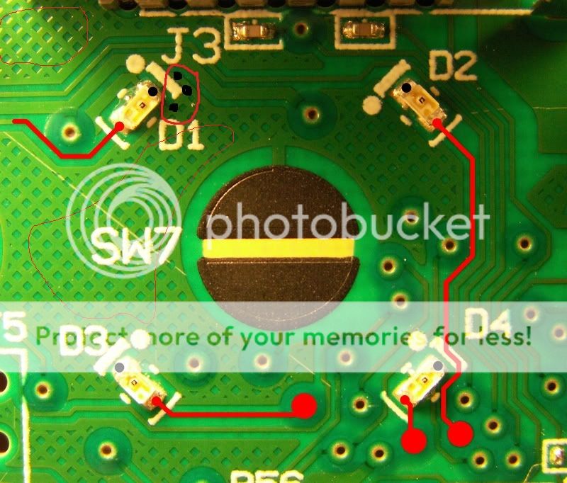

I do not think there are any vids on this. Best thing would be to find a picture of the traces with them outlined. I have one around this forum somewhere i will edit into this post asap.
Picture is not mine.
Here it is. Just run a small wire as a jumper. You may need to scrape down to the copper to make a spot. I have been lucky a few times and be able to pick up the trace just after the "tear". This has allowed me to run a small bead of solder instead of a jumper.
If you can post a pic we could help locate the best spot.

There are not any vid tuts on this subject because there are to many variables. For your problem you can either:
Run a wire from the - side of the LED straight to the ground battery terminal. Be careful with the wire to make sure it does not run across and pads or any spot where it may bind in the shell.
or
Run a very small wire to the - side of the led from a trace near the LED. I have uploaded a pic with 3 spots picked out. Just scrape a small dot of the trace and tin it. Then solder a small bit of wire to the trace and then the - side of the led. I find it is easier to trim your wire to size using nail clippers after it is soldered in place.
Picture is edited by me but not my original.
« Last Edit: March 05, 2013, 10:34:30 AM by Modded Matt »

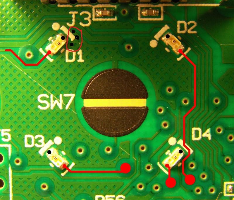

Hopefully this picture comes up...
This is the contact point that came up when I tried to change the LED. I've seen several videos and websites that called it the negative side (yes, for the wireless CG controller), but now I'm wondering if it's the positive side... Either way, the video tutorial I used was correct with the other three LEDs, as they work beautifully, but it's probably a bad idea to keep picking at the trace because I've messed it up more by assuming it's negative when it's actually positive. So what side is it? Again.. sorry for my lack of understanding. I'm a psychology major and therefore technology dumb.  :dntknw:
Whatever side it is, though, I'm guessing that I'll still need to expose part of the trace and solder the wire to it and the LED.
Offline ViSioNXx
  • Global Moderator
  • Posts: 381
  • PC Guru
Re: Looking for LED Trace Repair Videos
« Reply #11 on: March 06, 2013, 07:05:51 AM »
If your board looks like the one in the picture then yes it is pos. The trace for it is in red so bridge to that point.
