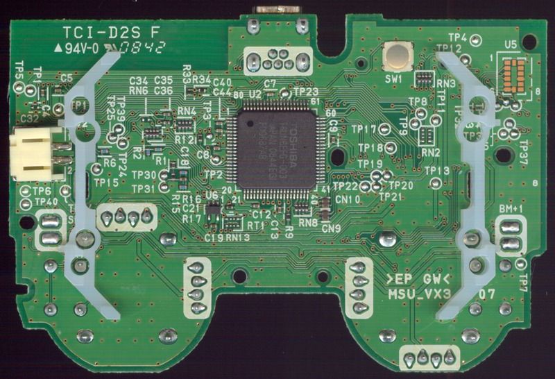

So I am having some trouble fitting the board into the controller, I saw RDC's controller and where he cut it but there are chips on the board that stop me from cutting there. I have uploaded pictures of my board and maybe someone can just take them into Paint and put a ride line where I should trim it.
Top:
Bottom:
  • Posts: 2671
Re: PS3 Controller into Xbox 360 Controller Shell
« Reply #10 on: April 24, 2013, 03:03:25 PM »
Just as I told you in the PM, there are no chips where I cut the board. The Sticks need to be removed, that's a given, then the left one rewired to some Vias as the bottom of the board gets trimmed and those spots will be lost.
If you're getting this idea the board needs to be cut that much from the first pic of the my PS360 thread on XS, it's the Trigger frames are what's cut so the board fits in there, it's not the board that's hacked up, though trimming the sides by 1 or 2mm at most might need to be done so it will fit after the Trigger frames are cut, but that's still far from any component on the board.
Offline paintlax21
  • Posts: 41
« Reply #11 on: April 24, 2013, 03:19:48 PM »
oh wow I feel incredibly stupid. Now I see that the trigger frames themselves have been cut that makes my life 100x easier...
