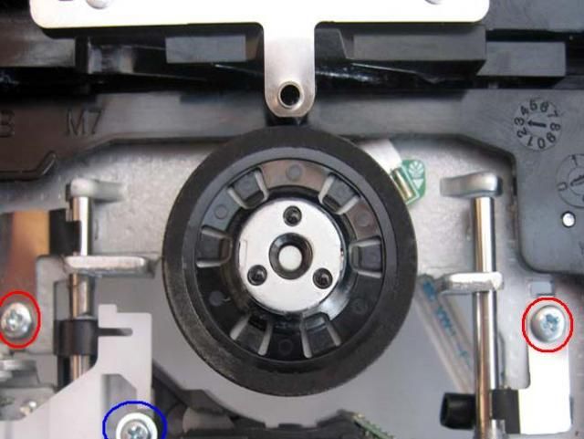

One Thing AbouT Xbox 360, Is That The Laser Sits On2 Silver Rails. You Should Take Note Of The Screw Covered In Blue Glue. As This Is The Height Adjust From The Laser To The Disc. If You Just Screw It In All The Way, Then It Wont Read Any Disc. I Recently I.stalled A New HitAchi Laser And Didnt Realized This Myself. Took An Hour To Get The Right Height So Itll Read Both Origi.Al And Ba,Kups Fine.

which screw? the one that holds the rails on? or the one that screws into the laser and attaches to the rail that moves the laser
If you do not touch them screw then you shouldnt have to mess with the height . so many people do the wrong things when trying to fix drives
do not mess with the adjustment screws on that hold the rails up off the dock !!!! leave them alone!

so which screws dont i mess with? the red or the blue? just wanna make sure i dont mess with them..or are they not in this picture?
neither! The ones undeneithe the rods do not touch there locktite in do not mess with the ones that prop the rods up off the doc.

Ok good I know I haven't messed with them since these are the only ones I've taken off lol. Well I'm going to get a multimeter tonight since it seems some lasers can be off a bit even from the factory so ill read what the ohms are and dial it down by .2 till it starts working.
