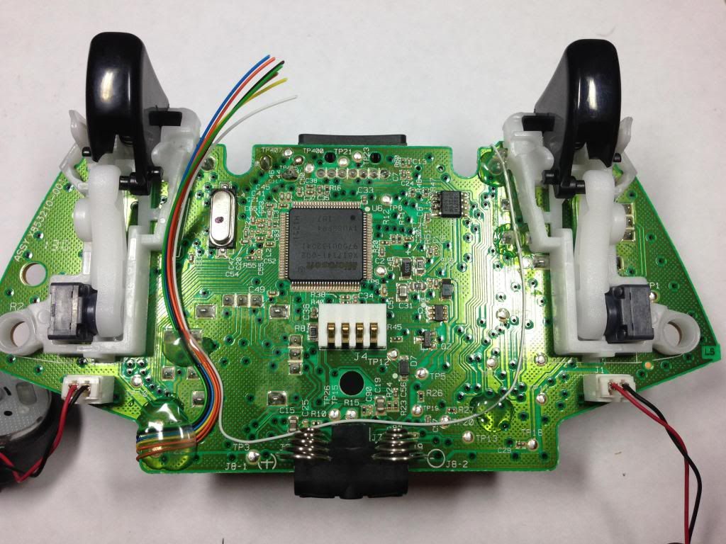

hey nerdy i already did this in my controlle  it was a pretty easy installation .. all though there is a little problem to where the Y cable conects to the 12f683 and the LB just switch the cables around .. but besides that everything is great thanks

Update: the Y and LB connections need to be transposed for this to work. Y goes where the LB connection goes and LB connection goes to where Y is labeled! The picture is not the actual CHANGED connections. U will have to switch these two wires to work.

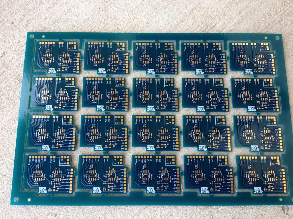

Looks Like My Boards From Another Project Came Handy for this Jitter Code, have Ton of these with IC Presolder If any one Need them Just PM me ,
You can Do single 12F683 or Dual 12f683 , I can send them Preflash with what ever code You Like if someone Don;t have programmer ,
there is programming pads On the back so you can flash it your self If you have Programmer.
This is the code I use in this project if any one want it You can pm me as well

just The PCB boards                   $1.00
PCB with One IC Unsolder           $2.50
PCB with 2 IC Unsolder               $3.99
PCB with one IC Solder &
Program with what ever code      $4.99
PCB with 2 IC solder &
Program with What ever Code     $5.99
Both IC get there power and Ground from PWR and GND ,  and IF you Jumper R2 and R1 you than have access to all the pins on U1 , U2 no Jumper Needed
U1 has R6 which is 10K for Pull ups for Pin 4 Like the Jitter.hex code
U2 has R7 which is 10K for Pull ups for Pin 4 Like the Jitter.hex code
« Last Edit: December 01, 2013, 10:45:04 AM by KingMike_OS »

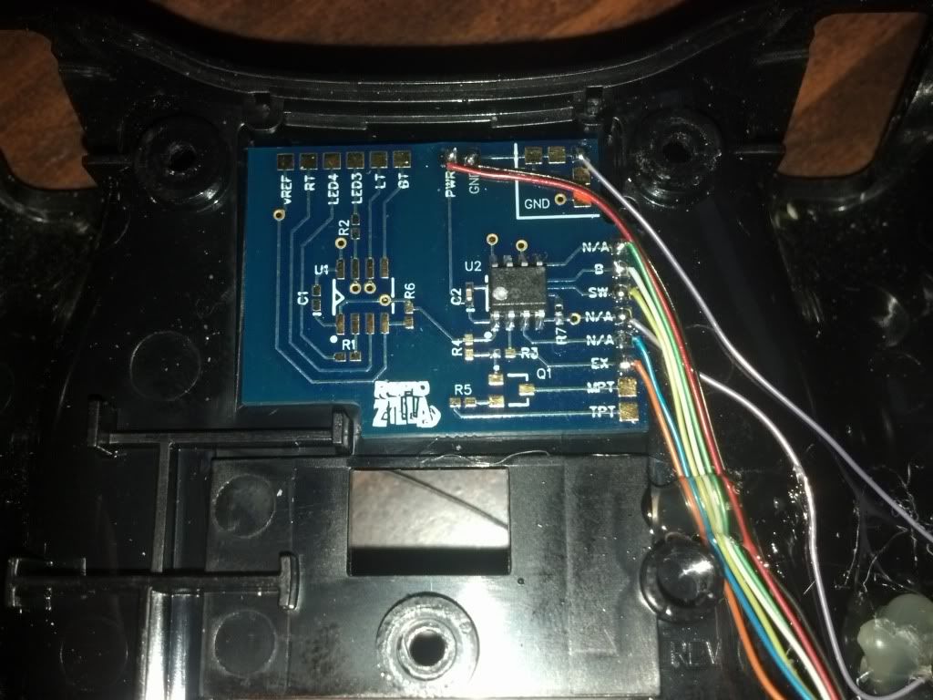

got in the boards from kingmike, will install this and try the jitter code on ghost.
Edit: Working great. One note though on the ghost jitter mod with the tac shotgun, the last 10 rounds doesn't fire nearly as fast as the first set of 20 rounds. Although it is not really a nother much. just something i noticed.
For those who are using this mod with Kingmike board, here is the wiring pad setup when the pic is soldered to u2
N/A = RT
B    = LB
SW = Y
N/A = Tact
N/A = X
EX  = Led/ROL
« Last Edit: December 06, 2013, 10:22:20 AM by Gizmo613 »
