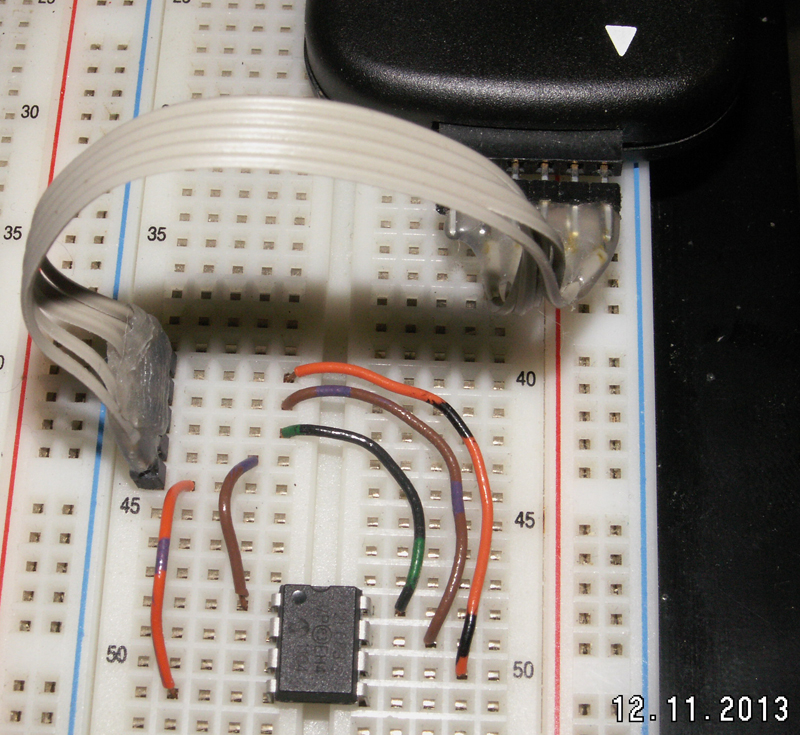

Guys I have received my PICkit 2 but I am a bit lost yet. I have downloaded the PICKit 2 v2.61 app how do I programm the pic? I mean, I have the PICkit, the usb cable, the 6 pin cable (both sides) now, do i have to use a breadboard for example? or i need this:

You'll need some type of socket or adapter.
If you have a bread board, and you should, then just use it.
On the PK2 the Arrow indicates Pin 1
1 - VPP
2 - VDD
3 - VSS
4 - DAT
5 - CLK
6 - Not used
On the 12F683
1 - VDD
2 - Not used
3 - Not used
4 - VPP
5 - Not used
6 - CLK
7 - DAT
8 - VSS
« Last Edit: January 08, 2018, 11:13:59 AM by RDC »

It works  :tup:, thanks (again) RDC for the reply.
