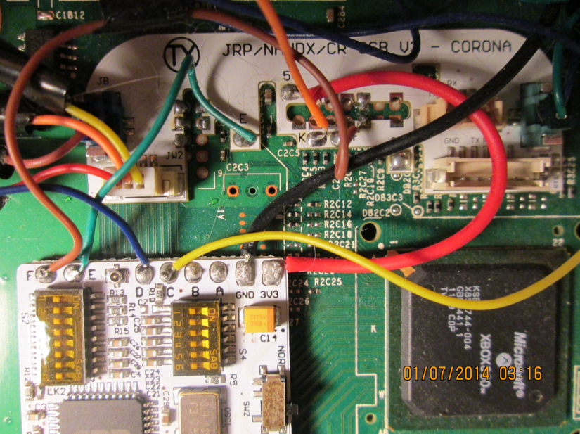

..So i tried to RGH my console a while back and forgot to change setting on my cr3 before connecting it to laptop and pretty sure i ended up frying it as when i would try to boot, screen would only stay black and i didn't get a splash screen or anything, then worked fine when reverting back to stock.
Well, i was just playing it stock for a few months and one day it said I had an E80 (wrong dash version i believe) and google is just running me in circles trying to find a solution.
The only reason I care is because this happened to my r2d2 and was my favorite of my 3 consoles. I have a halo3, a white console, and my r2d2 after giving my second white console to my father and my second halo3 to my sister.
I not only like the console, but it has sentimental value to me to having it back running would be awesome.
- if this has been posted somewhere on the forums already, im sorry, i searched and came up dry. Thanks again for all the help, it really means alot.
Pictures of my RGH install:
[spoiler]
[/spoiler]
R6T3 resistor is untouched:
« Last Edit: January 07, 2014, 03:23:40 PM by gl0zz3n »

did anyone actually see his pics?
im not trying to make fun of the OP but he needs to clean up his solder work
that bottom QSB for the cpu RST looks suspect
plus i never personally used that CPU rst qsb but im sure you are not suppose to solder to that point (yellow wire in pic) but on the qsb or am i wrong?
dont think its a update issue unless the LDV were modified

Needs To Clean Up The Soldering, And That Yelow Wire Is For Post Out, Which Is Connected To The Right Spot.

Yeah, i followed the diagrams to the T, and yes, im aware my soldering is poo, lol. I haven't removed anything because i haven't went and bought another iron yet.
Re: Could someone please help me fix my E80 error? (r2d2 360)
« Reply #13 on: January 07, 2014, 03:06:25 PM »
1st  USE FLUX!!!!!
2nd thing is in your pics with the CR3   there is no settings
3rd doesnt look like you need to bridged the resistors on the motherboard looks like there done
4th  what is the Orange Wire ? (K) go to  you shouldnt even need that wire with a cr3
as for the E80 error  if you tried to update the console by usb  and then tried to use your orignal nands you dumped before the update then that is the issue you need to redump the nand if you updated it.
cause the LDV would of changed. if you tried to RGH it again with the old nand .
show here wrong LDV

Everything looks good on the board, my only concern are a couple of these pads:

you lifted that pad clean off  :confused:
hard to tell about the other pads as the picture angle isnt good or lack of focus

« Reply #22 on: January 07, 2014, 04:21:27 PM »
that may be fixable!

Yeah, i didn't know if you could work with that or not, here's some better ones from different angles
( i learned how to use the image upload finally, lol )
Re: Could someone please help me fix my E80 error? (solved)
« Reply #24 on: January 07, 2014, 04:30:09 PM »
I wont know till i see it for sure and follow the traces.
