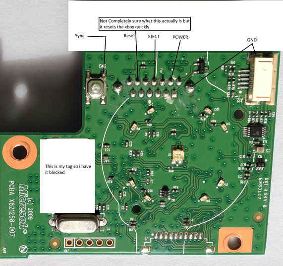

Hey guys, So I've quickly made a little YouTube tutorial which basically shows me testing and demonstrating exactly which pins you need to solder to if you wish to make a custom case mod which will have momentary push switches,
this could range from wiring up PC buttons from a PC case, or as I am doing, ordering your own and building it by yourself.
My Main reason in making this tutorial is to basically just show you guys how simple it is, There was a pin out floating around, but I know a lot of people won't attempt something until they know it works,
I hope this inspires you guys to make all sorts of wonderful things.
My current project is essentially a Xbox 360 and Ps3 combined into one case, with a flip out monitor. I will make a thread on how I have done it all upon completion.
How to solder on external buttons for a custom 360 slim case mod
