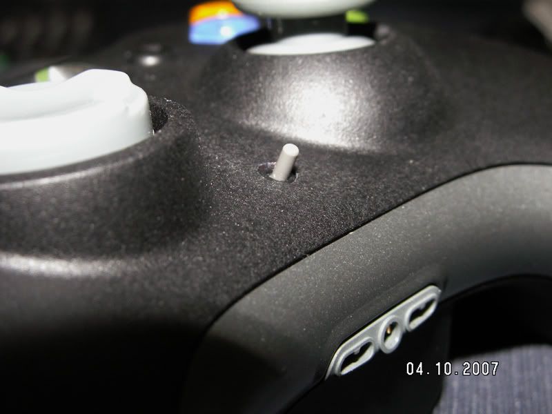

You'd need a PIC and a DAC to do it with a simple Tact button.
Use a DPDT switch. Sever the AN+ and Ground traces to the Y-Axis POT, or pull the POT and bend those leads up and wire to them that way, then wire the DPDT up in there. Switch in one position the Y-Axis is normal as AN+ and Ground go to the normal connections of the POT, flip the switch and they swap and then it's Inverted.
Ignore the wording and just wire the Left side to the controller's AN+ and Ground, then the right side to the POTs outside leads after isolating them.
This is the G22AP DPDT Toggle switch, little pricey at $5, but it's nice and small.

It's possible with a DPDT switch and 4 wires that most anyone could do, or a PIC/DAC and some code and 6 wires if a PCB is made up for the PIC/DAC.
